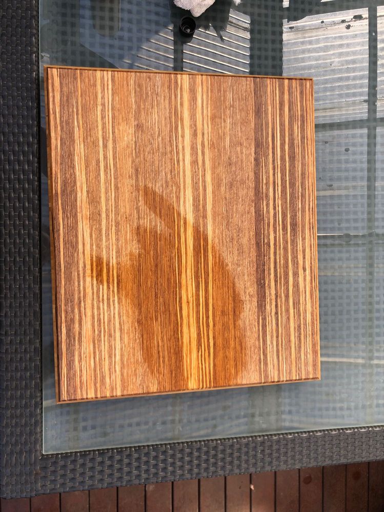

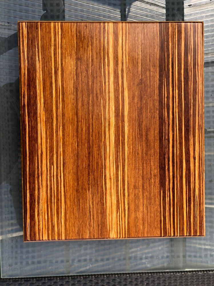

Re: Varnish Chopping Board
Oh wow, Derek (@dprice1)! That's really bought out the beautiful timber grain. I must say, though, if I was on that Zoom call and saw you sitting there with that delightful spread, I'd be just a touch jealous.
What product did you end up using, as I'd love to recommend that again?
Many thanks for posting the finished product, and well done.
