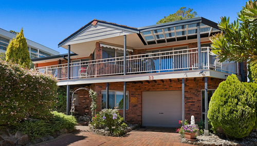

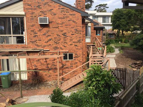

So, I bought this house that had the front entrance on a 2nd level on the back of the house. Obviously not ideal, especially when it came to deliveries. The only option in creating a new front entrance was to sacrifice the single garage. This is how how did it . . . . .

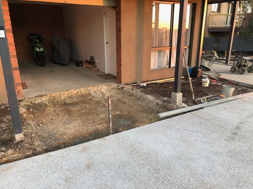

The ground in front had to be dug out below the concrete slab and a drain installed across the front to ensure not water ingress.
Then the roller door was removed.

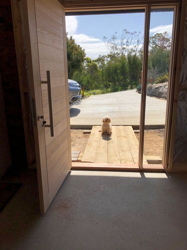

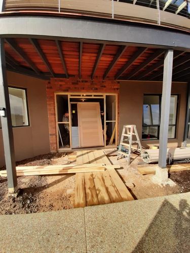

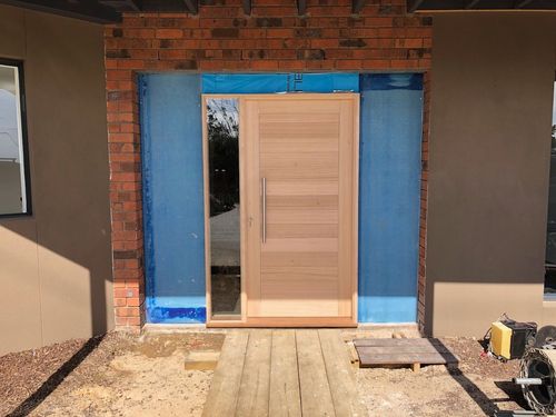

I ordered a 1100mm solid timber door preinstalled to a jamb with side glazing. Once that arrived I was able to frame out the old garage opening to suit. I needed a hand from a mate with this project in various stages to help lift and position the new door into place.
Around the same time I was also preparing the external brick work for rendering as they were not flat and needed to be hand ground down.

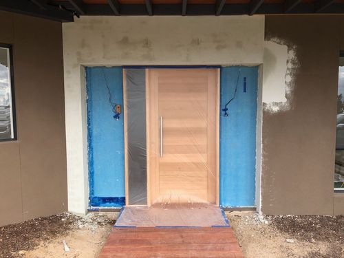

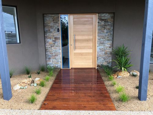

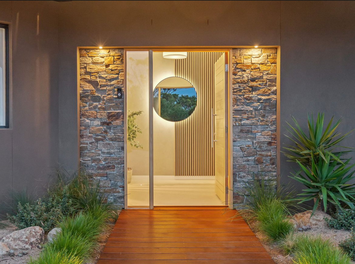

I fixed blue-board to the out entrance frame which was to be inlayed with a feature stone tile. Then tested the entrance with my first little visitor.

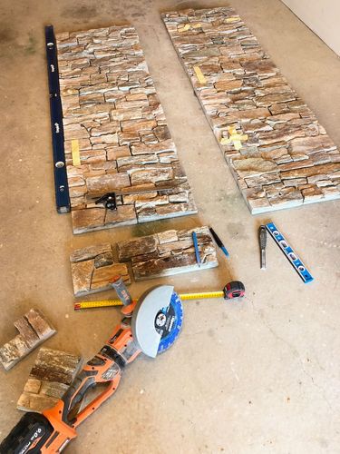

Next was to render the blue-board, then pre-wire for feature lights and a Ring smart doorbell before installing the stonework.
With the drainage installed and approved I build a small entrance deck leading up the front door and landscaped each side.

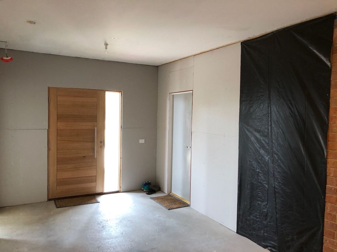

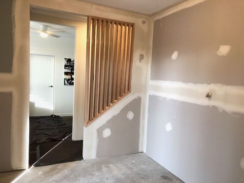

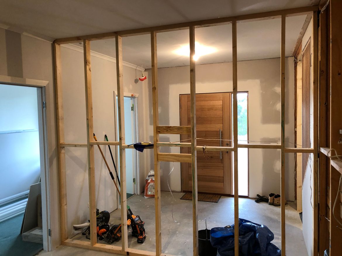

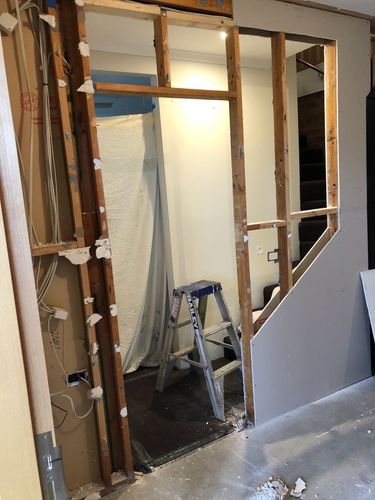

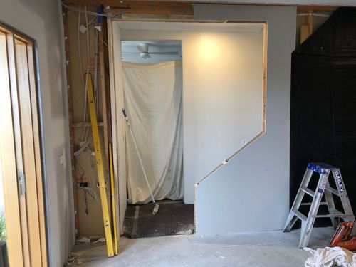

With the external entrance part finished, it was time to start on the internal space by gladding the brick with plasterboard and building a dividing wall within the old garage. Behind will eventually be a small living space as part of a new guest bedroom.

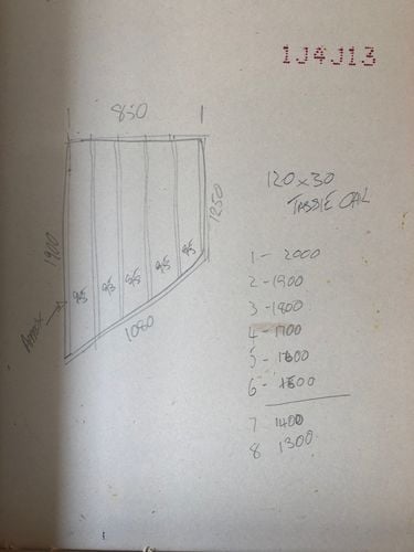

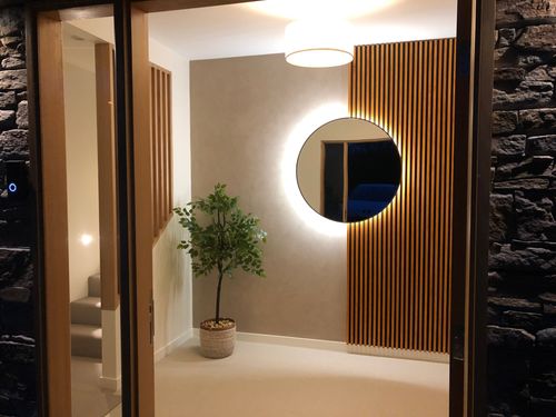

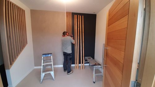

I wanted to open the staircase up leading up to the 2nd main level of the house as it was very narrow. I was inspired by some designed I had seen and came up with a timber slated feature that I made from Tassie-Oak. Once made, I then cut and prepared the staircase frame to accomodate.
I underestimated how heavy this was and called on my mate to give me a hand to install it. Then I was able to finish the walls.
The left hand back wall was plasterboard which I finished with a Deluxe texture paint. the right side was MDF panelling to allow me to fix 19 x 42 DAR pine to.

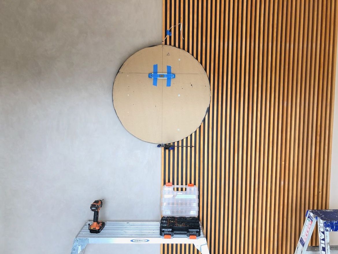

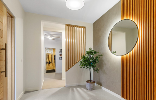

I mounted timber blocks to the centre of the wall to fix a round feature miterer to give the impression it was floating off the rear wall. I had pre-run a cable to the back ready for an LED light strip I wrapped around behind the mirror.

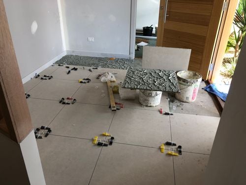

Next step was to tile over the old concrete floor with large format tiles.
Then install the skirting, architraves and paint the walls.

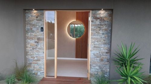

Fit a new feature light and project completed.

Great job with the door and surrounding stonework, it gives a beautiful modern look that is very inviting, and the backlit mirror is a beautiful centre piece that draws in the eye. It looks like something you would see on the cover of a design magazine.
I'm a big fan of the vertical batten dividers, and tassie oak is a beautiful timber to make them out of. They give the entryway so much warmth and depth. Did you use any oils or finishing products on them?

Thanks very much for the generous feedback @JacobZ. This was one of the more enjoyable and less challenging projects. My only real hurdle was having to have a min 50mm external clearance below the concrete slab at the door sill without have to have a channel grate between the deck and door sill. I managed to conceal this within the cavity under the entrance deck.

When it comes to tiling, I'll do small area floors like a laundry or a splashback, but anything larger where I need a perfect level finish I call in the tiler. After I needed to apply some self-levelling compound I was the this labourer to lay the tiles, which gave me the opportunity to learn from a pro.
The timber feature matches in with another at the top of the stairs, which I'll share in another project. I finished the timber using Carbothan's clear poly satin varnish non-drip formula with a very fine sand between 3 coats. Its non-drip helped to prevent pooling at the lower joining sections. I used the same product on the front door.
