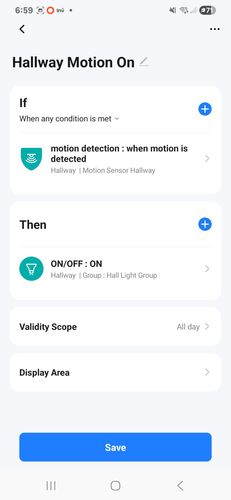

If you go into your app and into your sensor if it is working you will have a log of when it it triggered like below. You can even turn on notifications for testing purposes (then turn it off as it's annoying)
Start from there.

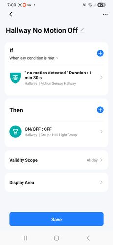

Also check your automation looks something like mine below.
The last 2 are how you set different brightness and intensity based on time of day.
Let me know  how u go
