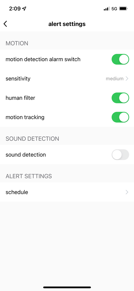

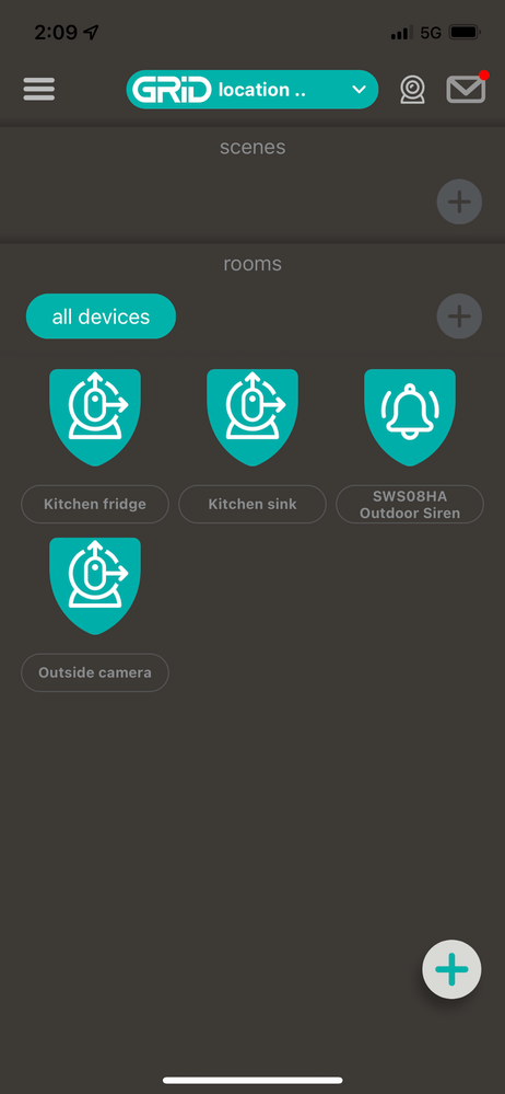

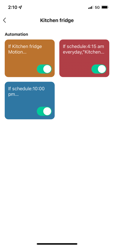

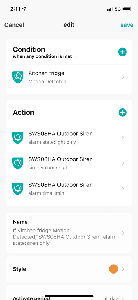

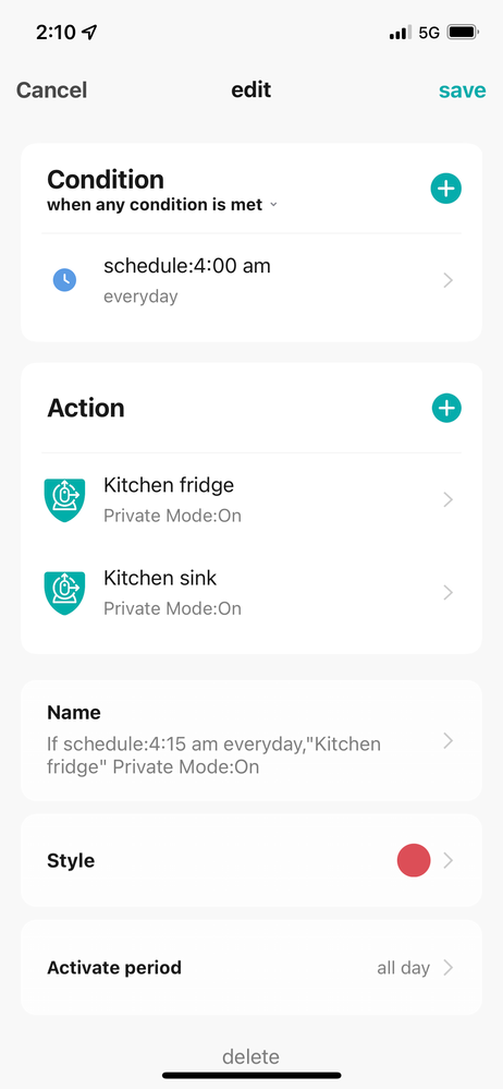

Hi Mike,
Thanks again for your offer of help. Here are relevant screenshots from the app. Basically, I have 3 sensors: outside camera; kitchen fridge; kitchen sink. Then I have an outdoor siren. I have focused on 'kitchen fridge' as an example. What I have tried to setup is for the sensor to become active (private mode off) from 10pm to 4am each day. During that active time if the sensor detects human movement it should activate the alarm (strobe light only). Its a similar setup for 'kitchen sink'.
Any suggestions appreciated. If you need any more info let me know.
Thankyou
Clive

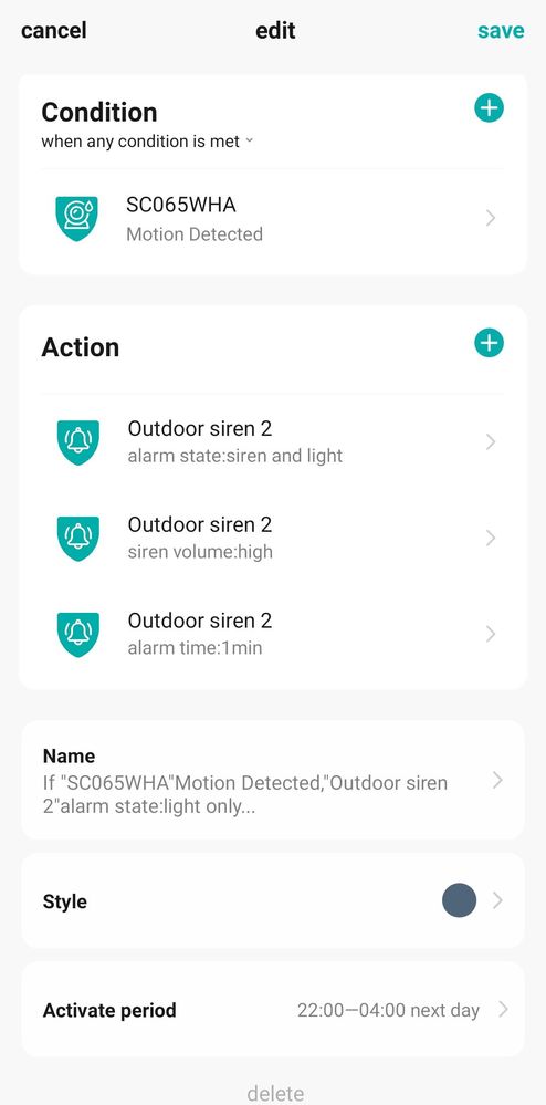

Hello @cliveg
I've just received a response from Arlec. I've shown them this discussion and they've recommended the following steps.
Below are the suggested instructions:
  • Firstly, ensure that the end-user has activated motion detection on the camera
  • Secondly, they have selected alarm state as light only in automation hence the siren is not giving any sound.
  • The activated period selected is 12-hour format instead of 24-hour format.
  • Please refer to the screenshot and create the automation accordingly.
Please note that even though it is referring to SC065WHA the steps she informed me of are the same. Please give these steps a try and tell me if it works.

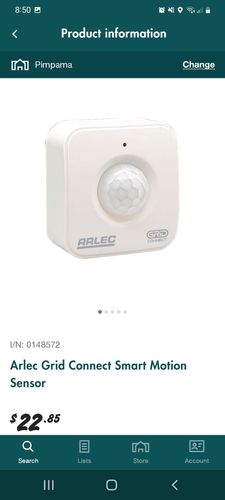

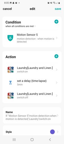

Motion sensor and inability to properly run timing function (delay) of different globes.
I have come across what looks like a software glitch within the ability to run GU10 globes and B22 globes in an automated countdown scene triggered by a battery operated motion sensor.
First off the GU10 globes have a built in software timer function within scenes, B22's, E27,E14's do not they have a countdown outside of scene which is a one shot countdown only.
The purpose of running a delay (timer) function of globes in scenes on a motion sensor is so you can walk into a room have the lights turn on automatically and then after a set time the lights turn off or perform another command.
So what's the glitch? With the 2 different globes combined the delay function becomes unstable and can turn the globes off anywhere from 5sec through to the set time of 5min and anything inbetween.
The following scenarios were trialled:
Grouping the globes and running commands as a group.
Running the GU10s with the in built timer and the B22 with a delay (timer) in the same scene
Running the GU10s under 1 scene and the B22 under another scene off the same motion sensor.
All of the above gave the same output.
The resolution was adding another motion sensor to the B22 and separation the 2 different types of globes.
The B22 runs on a delay (timer) function whilst the GU10s run on the inbuilt timer function.
These motion sensor are very effective there is just some software bugs.
Edit.......
Since writing and posting this post this morning I am in the laundry trying to do some washing and the B22 globe is on off, on off like a disco the motion sensor is not holding the delay timer at all even on a single globe. I will contact Alrec again to see if they are wanting to respond this time I will see if I can get a resolution for all.
Carl

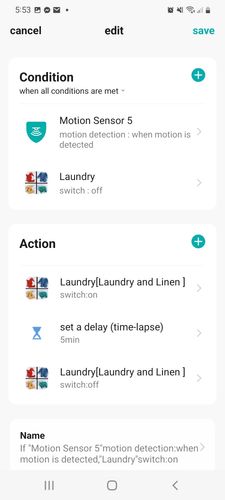

Below is the automation chain to overcome the blinking light associated to this sensor and certain globes / light fittings without built-in timer function.

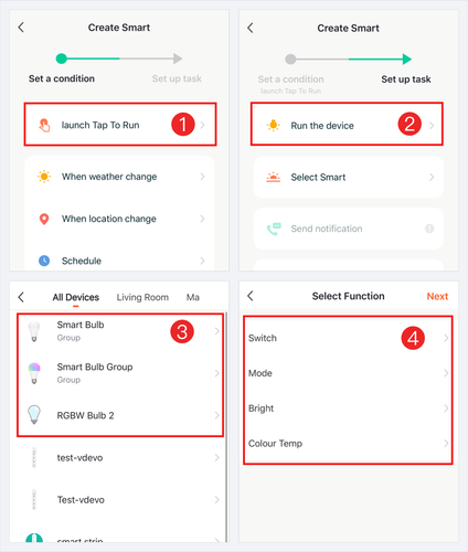

Tap-to-Run
There are three types of Tap-to-Run in the App. You can quickly start smart devices in your home by setting up Tap-to-Run, eliminating the setting step one by one.
Operating device: Add the smart device you want to execute the Tap-to-Run.
For example: you can enable all devices in your home without going to enable the device one by one.
Select smart: Add the automation you want to perform with Tap-to-Run(The existing automation is required in advance).
For example: you can use Tap-to-Run to open your setting automation without triggering any conditions of automation.

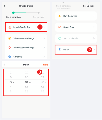

Delay: add a delayed task.
For example: you can add a delay task in Tap-to-Run between two devices actions.

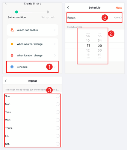

Schedule: The linkage between schedule function and the devices.
For example, you can set ‘open the curtain at 8am on working days.’

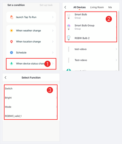

When the device status changes: The linkage between the device status change and the devices.
For example, you can set ’when the air conditioner is on, the aroma diffuser and air purifier will be automatically turned on, or when the door sensor is on, the alarm will be triggered

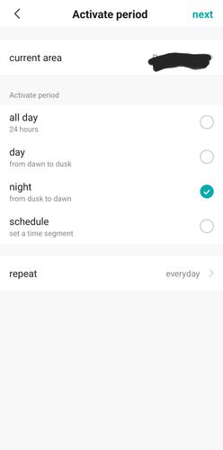

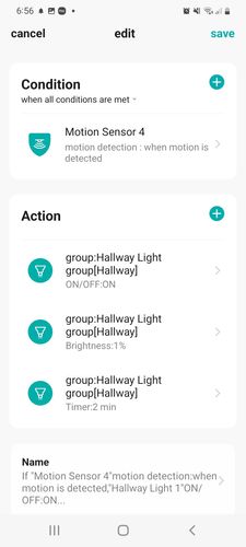

Setting active time periods on automations.
When setting up your automations right down the very bottom you have an active period selection, click on that and you have some options from there you have an array of choices that are self explaining.
Just check your location is set correct.

Hi @CSParnell
Thanks for sharing that handy tip, I was always under the impression that the lights had to be individually programmed to do this. But the grouping command will definitely make it so much easier.
