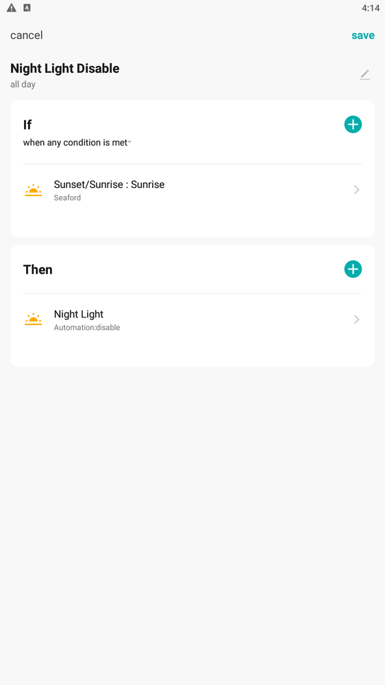

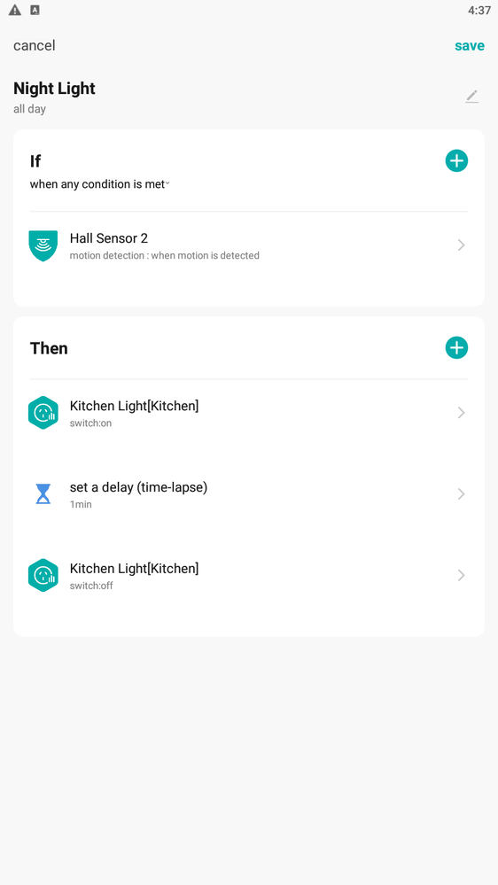

'Activate Period' Tip:
At some point you may wish energise some device at a certain time and have it switch OFF at sunrise or sunset. Unfortunately, as far as I can see, there is no way of doing this directly with the Grid Connect App – BUT it can be achieved in three simple automations.
As an example, I have a light I want to only turn ON for 1 minute when movement is detected after midnight, but I don’t want it to work between sunrise and midnight. As far as I can see, there is no way of achieving this with the Grid Connect ‘Activate Period’.
Solution:
1. Create an automation ‘Night Light’ to switch the required light ON if motion sensor detects movement.
2. Create an automation ‘Night Light Enable’ which enables the ‘Night Light’ automation at 0:00.
3. Create an automation ‘Night Light Disable’ to disable the ‘Night Light’ automation at sunrise.

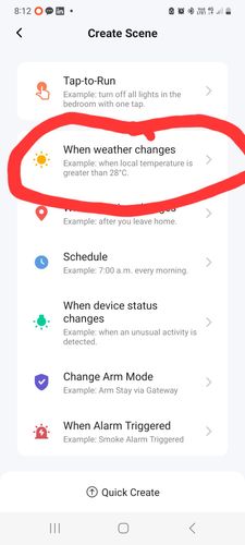

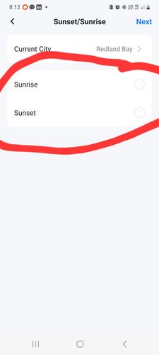

@GreenHouse I'm not sure if Grid Connect is the same as Smart Life but in SL you can select the following for Sunset and Sunrise Options.

Grid connect is the same.
You can enable an automation from sunset to sunrise etc no problems – BUT - you can't directly enable something from say midnight to sunrise.
Hence my tip, unfortunately using 3 automations to combine a time / weather related activation period.
It does amaze me how you can get around things with the limited instruction set. I would love to see some basic improvements in the instruction set, not the least being ‘if-then-else’ and ‘for next looping’ capabilities etc etc. Oh well, one can dream!

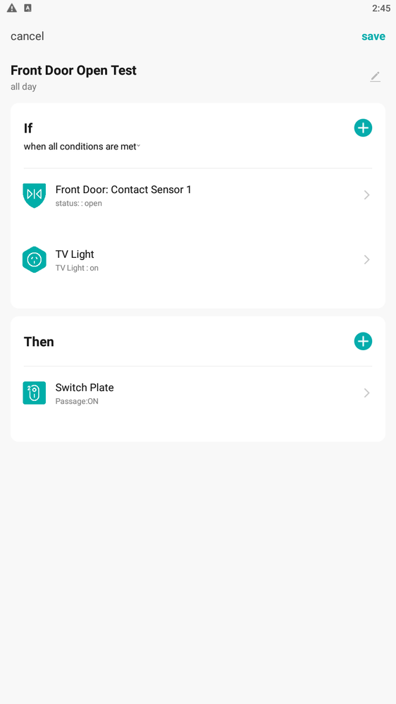

Switch Status Testing.
Problem:
At some point, you may wish to check the status (ON or OFF) of a Smart Switch in an Automation ‘If’ condition test, and if ‘True’, perform some Actions. Unfortunately, there is no direct way of doing this in the Grid Connect App (that I’ve found), unless it’s status has only just changed.
As an example, if the front door has been left open, I want the passage light to be turned ON if I subsequently checked.
Unless the front door was only just opened, the condition test for it being open will not work.
Solution:
1. Write an Automation which includes a Condition Test for the front door sensor AND the status of some other device. (In this example, a test to see if the TV light is ON.) Make sure you include: 'When ALL conditions are met'.
In the THEN Actions, include all the required actions. (In this example, just switch the passage light ON.)
2. Write a Tap to Trigger Scene to turn the TV light ON, delays a short time (to give the above Automation time to run) and then turn the TV light OFF.
When you click the Tap to Trigger Scene, the TV light will turn ON. This will force the automation to run which will test for the front door switch being open and then perform the scheduled actions if the door is open.  And, the Trigger Scene will finally turn the TV light back OFF.
It appears that whilst you can’t directly test the current switch status of a Smart Switch, if you combine the ‘If’ condition test with some other status change you initiate, Grid Connect will check BOTH conditions!
Who knew!?  -  I only just found this out by accident today.
Automation and Tap to Trigger Scene Example:
