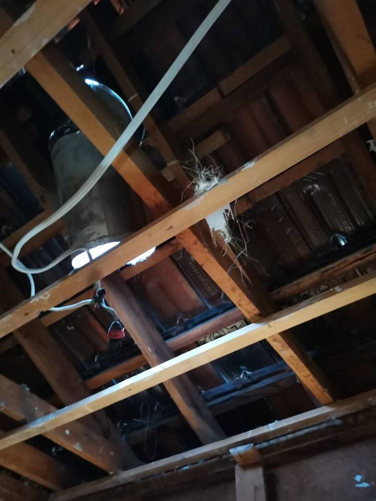

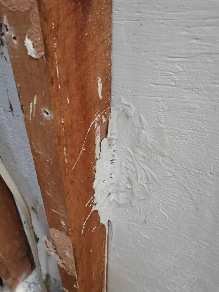

Hi All
Not sure if anyone has any experience for this. I am renovating my bathroom and just took off older plaster board. It is the old type frame timber and plaster board which has a lot twine in it. The plaster board was attached by some nails and plaster with twine.
The big question is about ceiling. Underneath the ceiling stud, a lot of small timber attached to it and the plaster board was nailed/adhesive to those small timber.
What should I do now? Attach the new Boral gyprock to those small timber with screw and glue or take off all small timber and attach gyprock to ceiling stud?

It would be best to check the installation requirements for the product you're using. I'll include an excerpt below. Those timber batons attached to the trusses (ceiling stud) are there to fix your plasterboard into. There wouldn't be adequate fixing locations for the sheets if you were to remove them as the trusses are too far apart. How far apart are the batons at the moment? They look to be around 600mm. If so, it might be worth pulling them off and adding additional batons, so they are spaced 450mm apart. This ensures there is no sagging of the sheets between their fixing points.

I'm not sure if I'm imagining this but in that first picture, there is a really dodgy looking electrical joint in them cables?
You need to have an Electrician fix this up and clip the cables in place before the ceiling joists/runners get installed.
Flying splices anywhere in a house is just not done and are a fire risk.
If you need any further advice, let me know.
