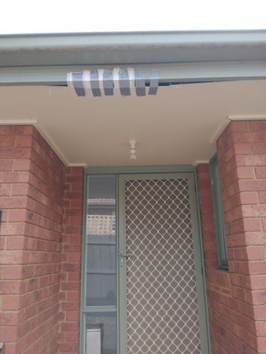

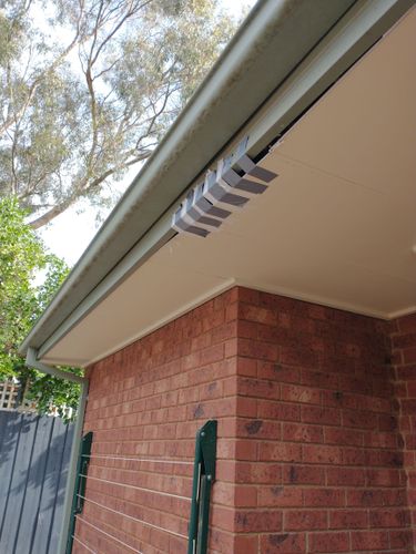

Hi everyone! I'm new to this forum and would love to get some advice on how to fix my roof fascia that seems to be falling down. I think it's caused by some house movement, because I noticed it got marginally worse after we had that little earthquake in Melbourne a few months back.
Is this a DIY job, or should I get professionals to come in? Scared it might get worse. here are some photos. I've used tape to hold it up as a temporary fix. Thanks !

The earthquake could be a possible reason and your fascia nails may have come loose causing the cover panel to drop. On the condition that this is not related to any form of water or moisture damage, you can fix this yourself. Look carefully at your fascia cover panel. You will notice that it has been nailed in certain spots. Those spots that they are nailed into are part of the roofing frame. I recommend using Paslode 30 x 2.8mm 500g Galvanised Fibre Cement Nails - 300 Pack.
The number one thing to remember is when you are nailing it back on, make sure that there is a timber piece behind it. You can then use Taubmans 250ml Sample Pot White to paint over the nailheads.
