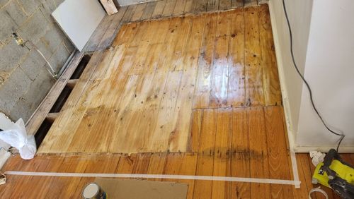

Photo 1:
I've started to apply CFP to the right hand side which I was happy with.
The left side of the applicator is the area that I've since stuffed up.

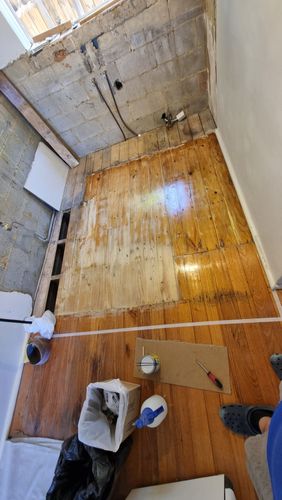

Photo 2:
This is after 1 coat. It looked promising that I thought a few more coats will fix it

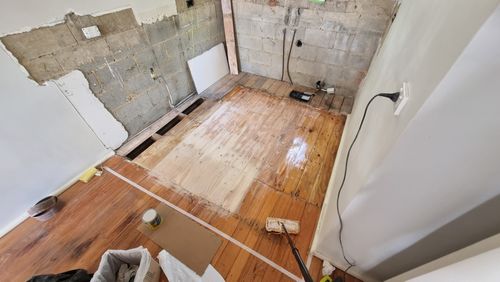

Photo 3: after 2 coats. It seems much more pronounced now. I've stopped after this to seek help.
Re: Help colour matching timber floorboards (staining and CFP coating)
Hello @dr_harika
I'm sorry to be the bearer of bad news but colour matching coloured varnish or sealer is one of the hardest things you can do. The original sealer applied to your floor has aged and has been exposed to the environment for a long time and is no longer its original colour, getting an exact match will be very difficult, the best you can hope for is a close match.
When the surface of a pine panel is not sanded enough the varnish sealer or stain will not get properly absorbed. Some sections will absorb it properly others will look different or behave differently. It's like it did not absorb the sealer or stain properly. The only solution is to sand the surface again allow the pine to rest and then apply your sealer.
