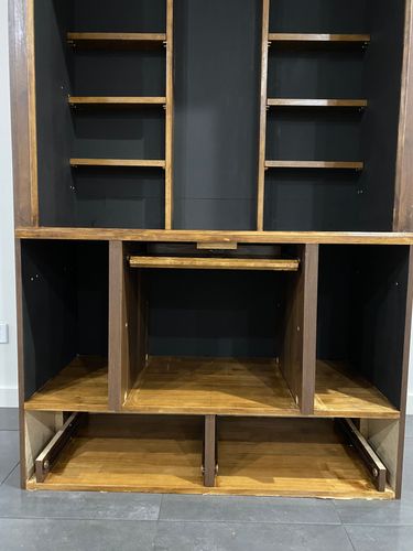

Hi Everyone,
After many hiccups, I completed my project. I Was very slow in getting a kick start, then in last month or so, I picked up my pace.
Here are some pictures
thanks @Benskimo for your inputs. That was really helpful and got me started. I ran into many road blocks while I was building, majorly with the tools, I have been to Bunnings many times over last 3 months.
Bunnings community, Please let me know your thoughts and suggestions to improve my work.
