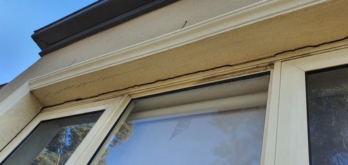

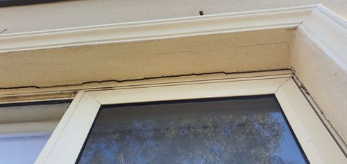

The noise appears to come from the top, the bottom and sides seem secure. When I gently push or tap certain sections it makes the creaking/popping noise.
I've attached more photos. I wonder if recaulking the gaps with selleys will help?

Does it make the creaking/popping noise when you press on the frame or just when you press on the windows? If it makes the noise when you press on the frame I suspect it is because the frame is not fixed firmly. By the looks of that large crack that runs across the top of the frame something has certainly shifted.
If you can, get someone inside the house to press the top of the window frame and from the outside observe that gap. If it closes up even slightly when the person inside is pressing the frame then that would indicate the window frame is not secured correctly. Depending on your level of D.I.Y. expertise this could quite possibly be a job for a carpenter.
