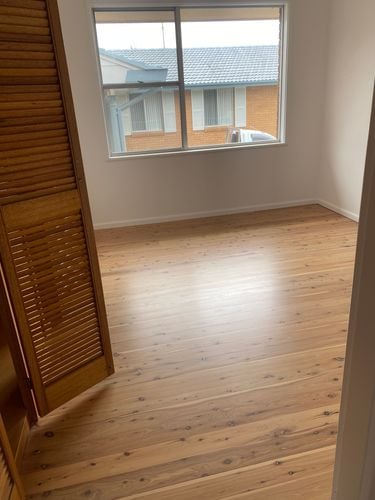

just looking for some desperate advice. I have just spent 6K on a floor sander to sand and varnish my floors to be a light Scandinavian type of look and the product they have used has made it look very orange.
Would anyone recommend a bleach or tint to create the look I’m going for (first pic of current orange floor and second of desired floor). Understandably the floor will need to be sanded back again but the floor sander is refusing to fix it.

Cypress Pine has a very orange-coloured heartwood that is amplified when coated. I have Cypress Pine floorboards, and they are WAY more orange-coloured than yours.
Typically a water-based coating is more clear and colourless, whereas an oil-based coating has quite an orange hue. However, a water-based coating over orange-coloured timber like Cypress Pine is still going to give you a slightly orange result. I suspect that the coating used on your floor could have been an oil-based product.
Your flooring appears to consist mainly of orange-coloured heartwood, with the limited lighter white sections being sapwood. Your inspiration image has far more lighter sapwood than your flooring, which adds to the overall Scandi style.
