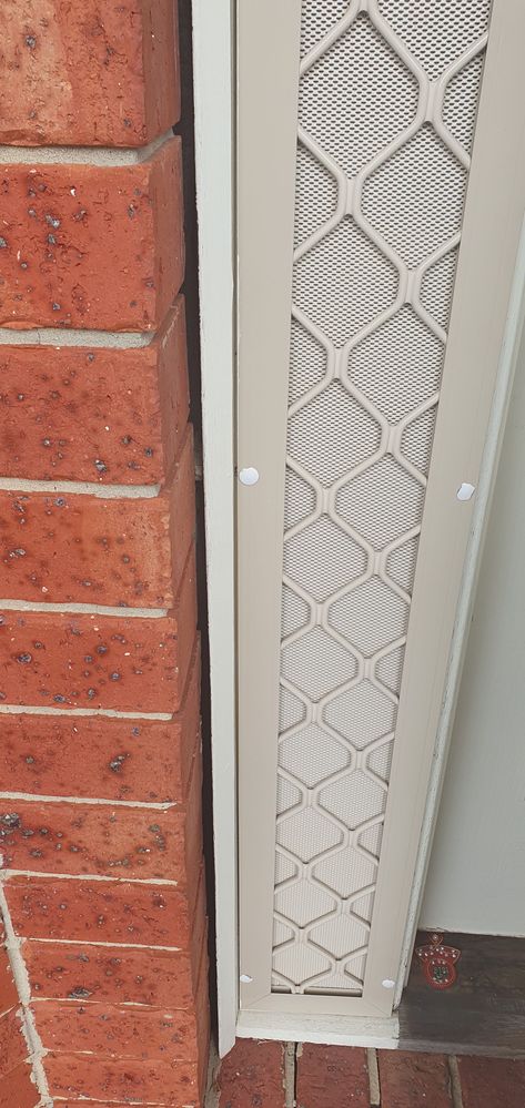

My home main entrance door frame and brick wall has a big gap from outside..
also the same issue with window frame and brick wall outside of the house.
please help me out.

Usually in these situations I would recommend using Selleys 430g White No More Gaps Exterior Gap Filler. But it appears that the space between your door frame and the brick wall is at the limit the gap filler can fill in.
I suggest getting a ruler and measuring the space of the gap. If the entire length of the gap falls under 10mm then it will be possible to use Selleys Gap Filler. However, if parts of the gap go past 10mm it will be necessary to use an H3 Timber Moulding to fill the gap and then use the Selleys Gap Filler to finish off the small gaps.
The timber moulding can be attached to the brick wall using Selleys 320g Liquid Nails Original Construction Adhesive. The timber moulding is suppose to be at the same level as the door frame. The same procedure can be applied to your window gaps but remember to measure the gap first to see if you can use the Selleys filler by itself.
If the gap is smaller than 10mm, I suggest using Moroday 10mm x 5m White Gap Filler Rod. The rod will prevent the gap filler from flowing too deeply into the gap. Make sure to push rod filler no deeper than 5mm so that you won't have to use a great deal of filler.
