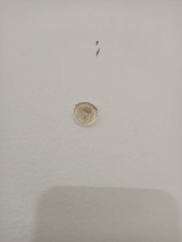

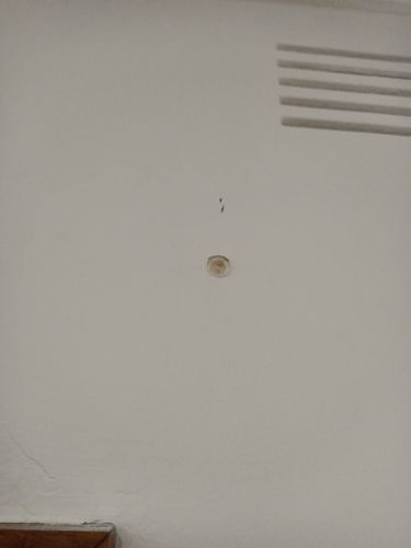

I've also taken photos of what the hole looks like now
Not sure if this really shows anything

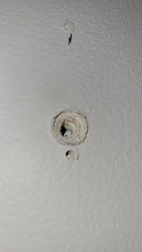

Here is what the hole looks like now:

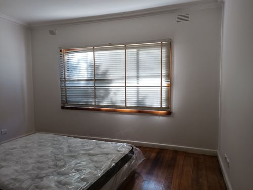

Before: (string on these venetians eventually broke and we couldn't fully close it on one side)

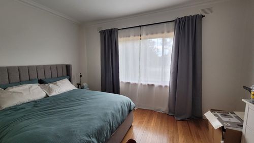

After:
Thanks everyone for your advice, much appreciated!
