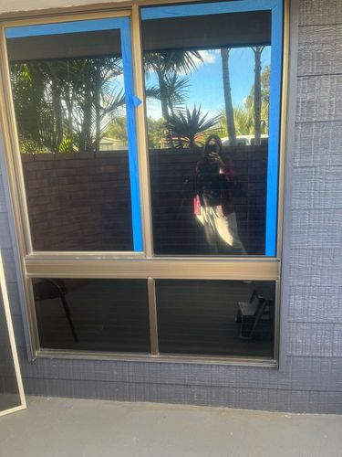

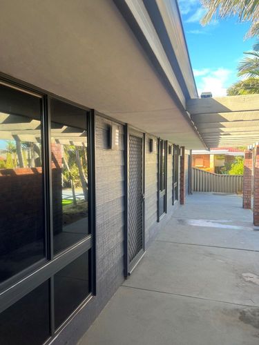

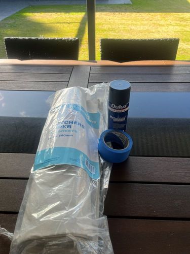

Hi Deeks it’s super easy Dulux spray can check out my profile I added instructions to n what we did the longest part is taping up the windows I went a bit overboard just didn’t want paint on my tinted windows good luck show us your pics once you do it ![]()
I added the pic of dulux paint can below you will need a primer too not showing on the pic
