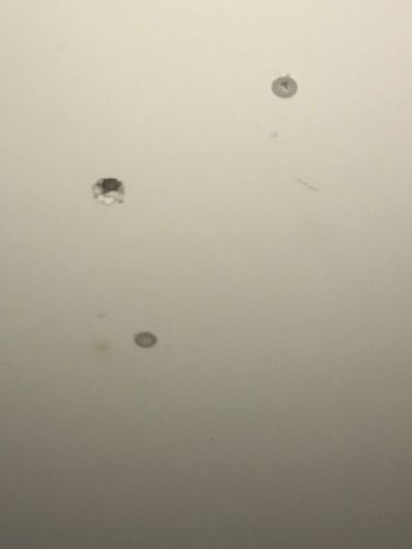

I removed a ceiling mounted light fitting which was secured to the plaster with a plastic screw in plug into which the metal screws were screwed. I want to remove the plastic plug without further danging the ceiling. Would a screw extractor do it?

Clarification - nothing electrical involved - an electrician had replaced ceiling fitting with LED downlights. When he removed the old light fitting the plastic plugs did not come away, and I want to remove them before I plaster over the holes and prepare ceiling for repainting.

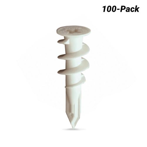

Welcome to Bunnings Workshop! What you have in your ceiling are plastic wall anchors. A typical example are Ramset plastic wall anchors, they are easy enough to take out. If you have a philips head screw driver, simply line it up with the plastic head and insert it in to the cross head slot. Turn anti clockwise to reverse the screwing action of the plastic anchor. Remember to do it gently so as not to aggravate the ceiling plaster board which you will need to repair. Once the plastic anchor starts to come out continue until the full body of the plug removes itself from the plaster board. Once all the anchors are out you can use a Poly Wall Repair Kit. Follow the instructions at the back of the tub to make repairs to your ceiling. Gently sand back to flatten and paint ceiling area that has been repaired. I hope the suggestions help and thank you for sharing your diy query, if you have any more questions please post it here on workshop.
Cheers,
Red
The Ramset wall anchors have a philips or cross head slot for installation and removal.Use this to repair your ceiling.

Hi Red
Your advice was spot on, and the anchors came out quite easily. My problem was they appeared to have no way of accepting a screw driver - but it did, and problem solved.
