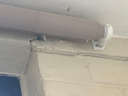

How do I best repair this section of what I assume to be concrete or cement render? Someone trying to drill into it caused it to crack, one of the lower pieces looks quite loose. Shall I remove it and build the area up somehow? What products would be best to use?

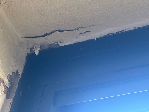

There’s also something strange happening on the other side of the window, see second pic.

I suggest removing your roller blinds temporarily so that you can access the damaged section of the render. Remove all the loose pieces and the green wall plug that is no longer needed, next follow the steps in this guide - How to repair a rendered wall by @Nailbag. Regarding the broken section inside your house near the window, I suspect that the person doing the drilling passed through the wall and overextended reaching past your window. If the render inside is loose and can be removed, I suggest taking it off and patching it as well.

Thanks so much Eric for your quick response, I’ll give the Polyfilla Exterior Brick & Render a go and let you know if I run into any issues.
