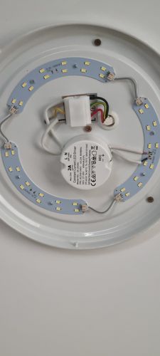

Hi guys this light in my bedroom is constantly flickering. Im tryingnto replace it but don't know what it's called or if I can do it myself vs calling in an electrician. It doesn't look like a standard down light. Thank you so much for your assistance

Most likely the LED driver is faulty and you will need a electrician and they probably replace the light fitting.
Just for interest sake.
Please take and post a close-up photo of that thingamajig.

This is a hardwired LED light, and as @AlanM52 has already mentioned, it sounds like it could be a faulty LED driver. Unfortunately, as this light fitting is hardwired and does not have replaceable bulbs, any issues with this light will require the assistance of an electrician.
