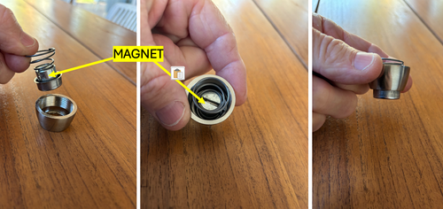

Re: How do you get magnetic door stopper to work?
Hi @Conservation
The photos below show the order of assembly. The magnet must be positioned centrally to the outer curved metal cover. It will magnetise to it. Then the spring. The door stop ball, needs to nest perfectly central to the curve of the door side magnet.
If assembled like this it will work.
Nailbag
Hi @Nailbag
Thank you very much for the photo guide!
