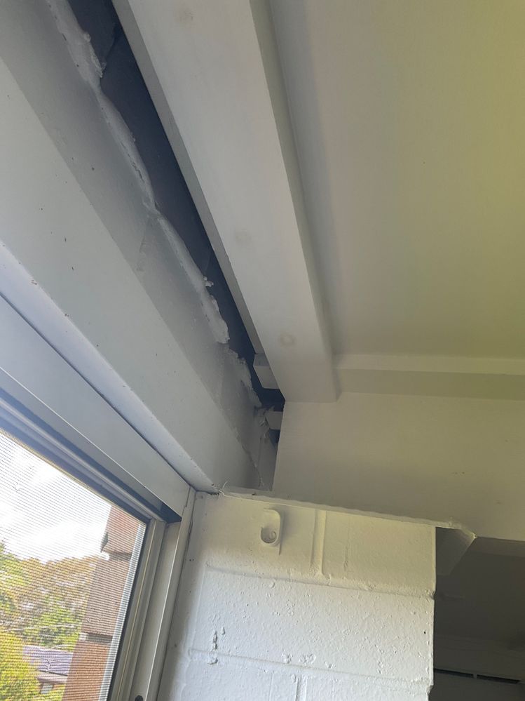

Hi @EmilyD,
Thank you for your question about filling a gap between your wall and ceiling.
The best way I see to close up this gap is to mount a piece of timber to the wall that is level with the timber running towards the camera at the top of your image and attach plasterboard to the underside of the two pieces of timber.
It's hard to tell from the photo where the level on the wall is in relation to this timber. I have shown two possible locations below that appear to be different materials.
The top line appears to be besser bricks, which you could use masonry anchors at 450mm spacings to mount 70 x 35mm Framing Pine.
The bottom line looks like it might be a steel beam, in which case you could use 50mm Tek Screws at 450mm spacings to mount your timber.
Once this timber is in place, use 30mm plasterboard screws to attach plasterboard to the underside of the two timbers, with the edge of the board flush with the outside of the timber as shown below.
You can then use External Angle Plaster Trims to create a nice clean edge before plastering and painting.
This is one idea that would work and look good but is certainly quite involved.
Allow me to tag @Dave-1, @Nailbag and @Jewelleryrescue to see what they think.
hi @EmilyD
In @JacobZ last photo with the dotted orange line I would builders glue (liquide nails) cut flat ply or any flat smooth ply like board Masonite onto that flat beam across to the wall. A timber batton can be pre glued on outer wall so a flat ply can span onto it and support it. I would cut the ply to match the outer edge of the roof beam? so it all looks more natural.
The repair is light ply weight so glue will hold plenty strong drilling into steel and brick is quite hard to do but a strongest option for heavier timber.
Liquid nails if placed onto the ply and pushed up there into place will transfer some glue to the roof area.
Now pull that ply back down. Counter intuative I hear you.
Wait 5 minite for the glue to partialy skin on the board and on the roof
Now push the board back up there the glue will grab fast like contact adhesive and shouldnt need support to hold the board in place.
Oh there is a fast grab version of liquid nails but never tried it.
Cover the remaining end hole with ply the same way.
Use no more gaps to seal any crack and paint.

Good Morning @EmilyD
I was thinking of a solution similar to @Jewelleryrescue but would use pine instead of another material. I would screw it to the timber strip on the underside of the ceiling and butt the edge of it up against the strip above the window.
