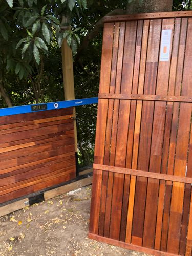

Hi, how can I fix this merbau speright screen panels to timber post?

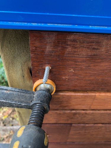

The easiest option would be to screw them directly into the posts. I'm building a project with them now and am using these counter-sinking bits to pre-drill the timber, so it doesn't split. I then screw the panel directly into the timber frame. It's working a treat. Make sure not to over-tighten the screws, or the timber will crack; just snug them up tight.

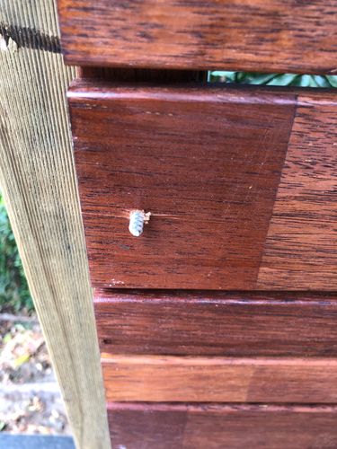

So I should pre-drill. Because I tried decking screws from front but screw head broke and then I tried same type of
screw from the back angled from post to the panel but panel timber cracked.
You can use decking screws, but they'd need to be the self-drilling type if you're not going to pre-drill, @Marten. You're going through a double thickness there, so I suspect the self-drilling type might also snap. I'd suggest pre-drilling as you are quite close to the end of the timber, and if you don't, it will have a tendency to split.

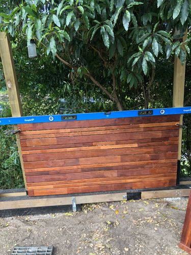

I got the tool. How many centimetres interval do you recommend between two screws?
The spacing that you currently have in that picture looks about right to me, @Marten. 👍 Five per end would be more than adequate.
