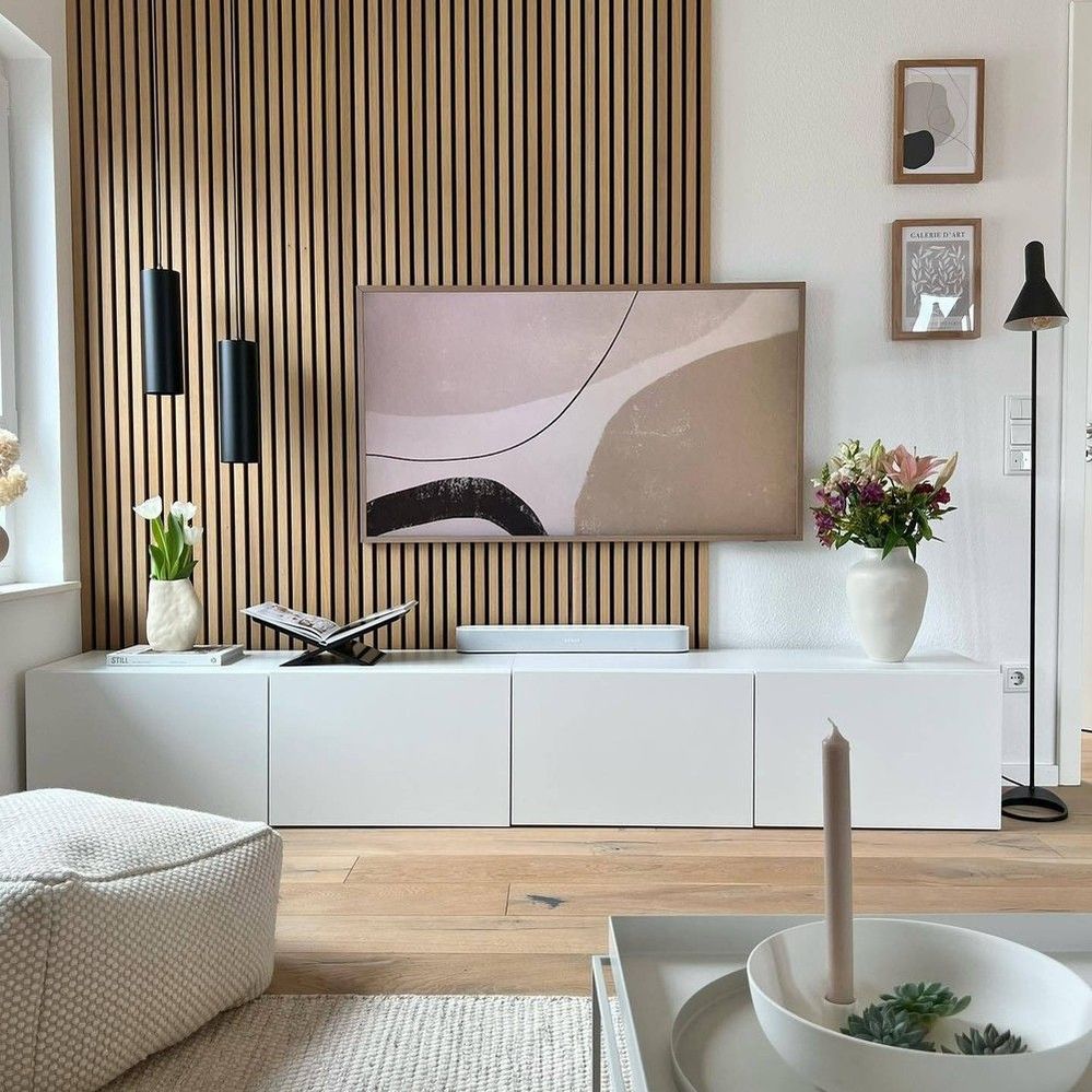

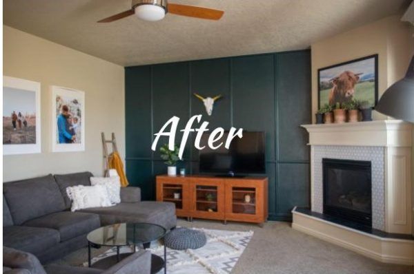

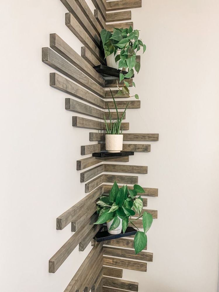

I am looking to build some accent walls in my house. The house has single brick on the internal walls. Do i need to drill and screw each piece in or would no more nails suffice?
similar projects attached
