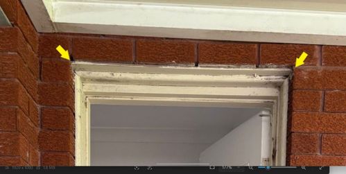

Looking for any advice and guidance on bricking up an external doorway (house is double brick).
Especially the best materials for the internal layer, Power block/Besser block etc and mortar.
The main challenge is the door frame and jamb, it's metal and can't be removed.
Therefore the internal mortar will be between Besser block and existing painted frame.
I've got 1 x block to size up (600 X 200 x 075). It's one of these...
https://www.bunnings.com.au/hebel-powerblock-600-x-200-x-075mm-130-plt-csr-powerblock_p0405017
It feels a little too shallow, so might go deeper 100mm depth. However, if using this dimension I can't build a 'running' pattern, so i'm assuming these blocks will need to be cut down. The internal wall will eventually have shelves drilled in, so needs to be pretty sturdy.
Photos and current plan are below.
Many thanks for your expertise!

Prep...
Remove door, hinges and wooden skirting.
Chip off floor tiles within the doorway, so base row of bricks can be laid level with existing.
External side...
Tooth out half bricks & old mortar either side of opening (Apart from top row due to steel lintel, which will remain).
Build up external bricks (have sourced matching style) with fresh mortar.
Internal side...
Build up with besser block type material, using the same mortar???
Finish with a render/plaster.

Since the Lentil is remaining in place, can you not use an angle grind to cut manageable sections of the steel door frame that could be then pry-bar'd out on your own. Thats basically how I had to remove one once.

I was thinking along the same lines as @Nailbag as to removing the old frame. Depending tho :smile: As there is always a depending. Does the metal frame support the bricks above (lintel built into frame) or is there a seperate lintel to support the bricks above?
I was also thinking of a false wall being easier to install. But rendering and matching what you have inside I dont have enough experience to suggest either or, False framing a wall up would be a LOT easier and as @EricL says you can insulate it.

The frame is supporting the lintel and I always say to myself, why do it that way?
To remove the frame you should be able to access the top five bricks from above on the roof.
Thing is... can you match those bricks?
Please let us know if you can...
If not I would do the Alcove thing on the outside.
