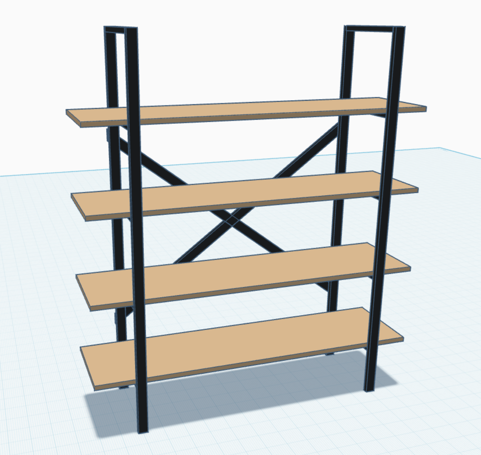

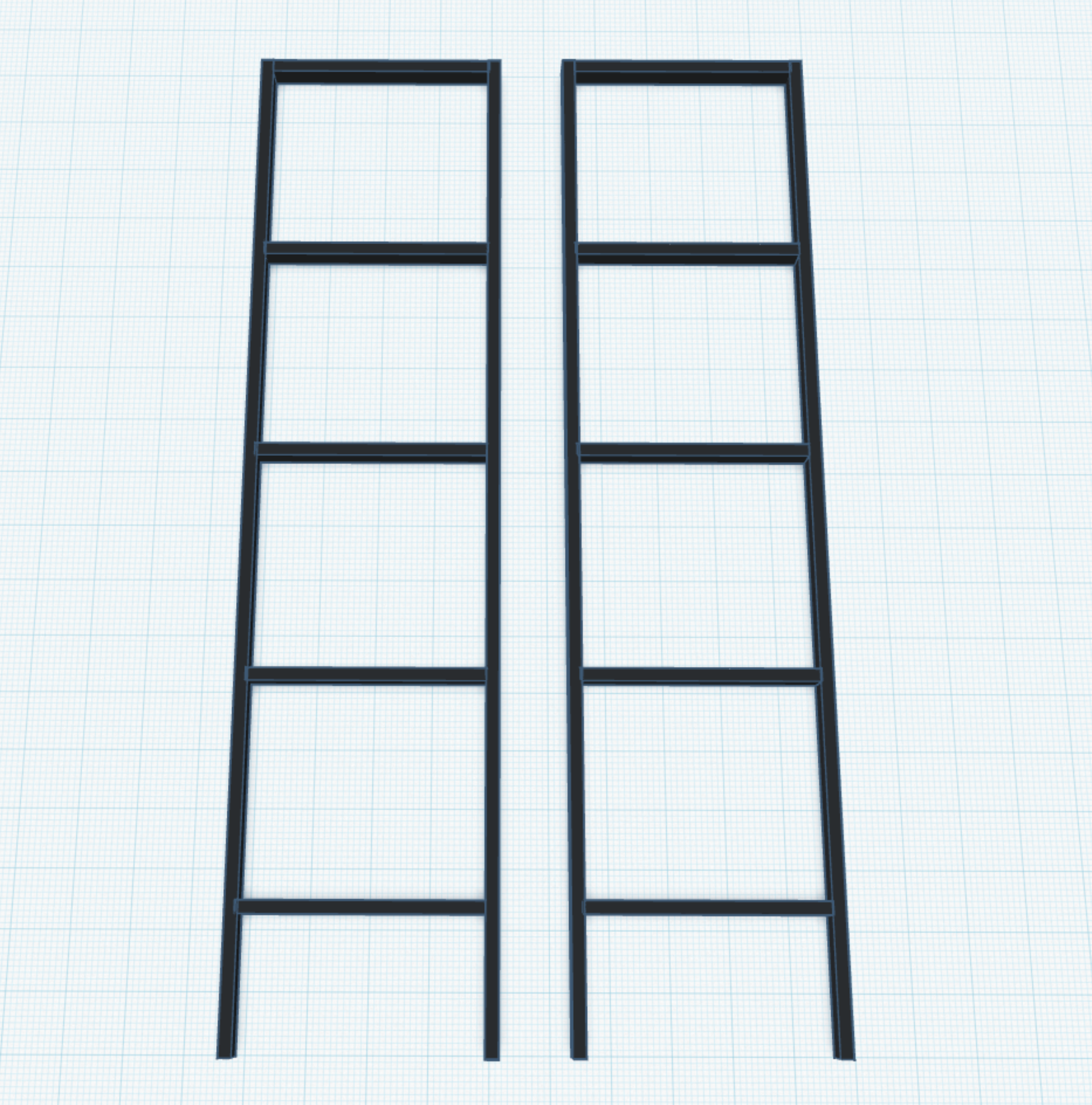

I think you could build something similar with SpecRite 1800 x 405mm 18mm Timber Panel Beech FJ Laminated and 42 x 19mm Pine. I've created a couple of renderings using that material for you. That would likely be the cheapest option, timber-wise. Apart from your drill driver, you need a handsaw or circular saw to cut the timber to length.
You'll need 60mm timber screws for joining the leg sections. Ensure you pre-drill with a 4mm drill bit. I also recommend you screw through the shelf supports up into the bottom of the panels, and 35mm timber screws would be great for that. I'd also recommend you use PVA glue on the joints for the legs.
