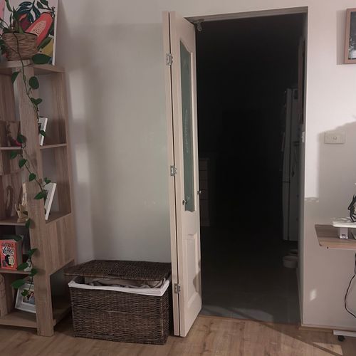

Hi
I would like to build my own barn door.
To replace the folding door looks so old.
I
don’t know what timber to use?
