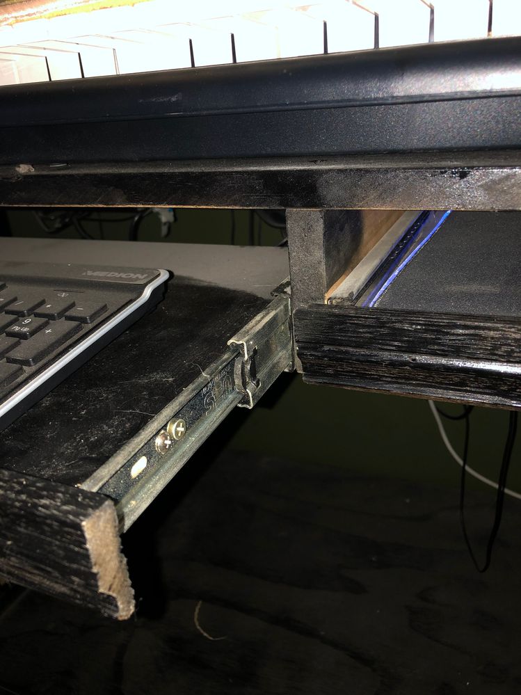

I play a  electronic keyboard teaching myself piano and I have a slide out  tray under the desk holding a computer keyboard and  mouse mat.
I used  draw slides mounted on two timber blocks of  wood underneath.

Hi @evo75,
I think @Jewelleryrescue's suggestion of adding a sliding tray might be the easiest solution. The product you've shown uses some very specific brackets to lock onto the edge of the desk. I am unaware of any similar brackets that could be used. If you were after semi-permanently attaching the extender, you could use brackets such as these steel plates screwed to the underside of the desk and the extender.
