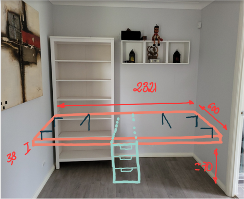

I want to use one of the walls on the upstairs landing to install a floating desk as it is an area of the house that we don't use that much.
All dimensions are in the sketch below. Materials I am planning to use:
- Ikea drawers 360mm wide in white. The idea is to have some kind of divisor with storage as well as a support in the middle.
- Smoked Oak Kaboodle benchtop. I thought this would be easier than installing actual timber and prepare it. The total weight of the whole benchtop is 40kg and i will be cutting a little bit to make it 2317mm (giving a couple of mm either side).
- Side Wall brackets. I initially thought on installing a builder angle (recessed into the gyprock) attached to the two studs but i couldn't find it in Bunnings long enough (600mm). Therefore, I am now thinking on installing 2 angle brackets as per the sketch (125mm brackets or 250mm, I am not sure) recessed into the gyprock.
- Back Wall brackets. I am thinking on installing 2 angle brackets as per the sketch (300mm brackets) recessed into the gyprock.
- Silicone around the benchtop to seal the gap.
- 2 x Cable management duct access at the back on the benchtop.
- Cable management tray below the desk (I haven't found anything yet online).
Any suggestions? I am a bit lost on the number of brackets and the dimensions that I need. Kaboodle recommends supports every 800mm but that said, that is also recommended for kitchens, not a desk that would not have that much weight.
