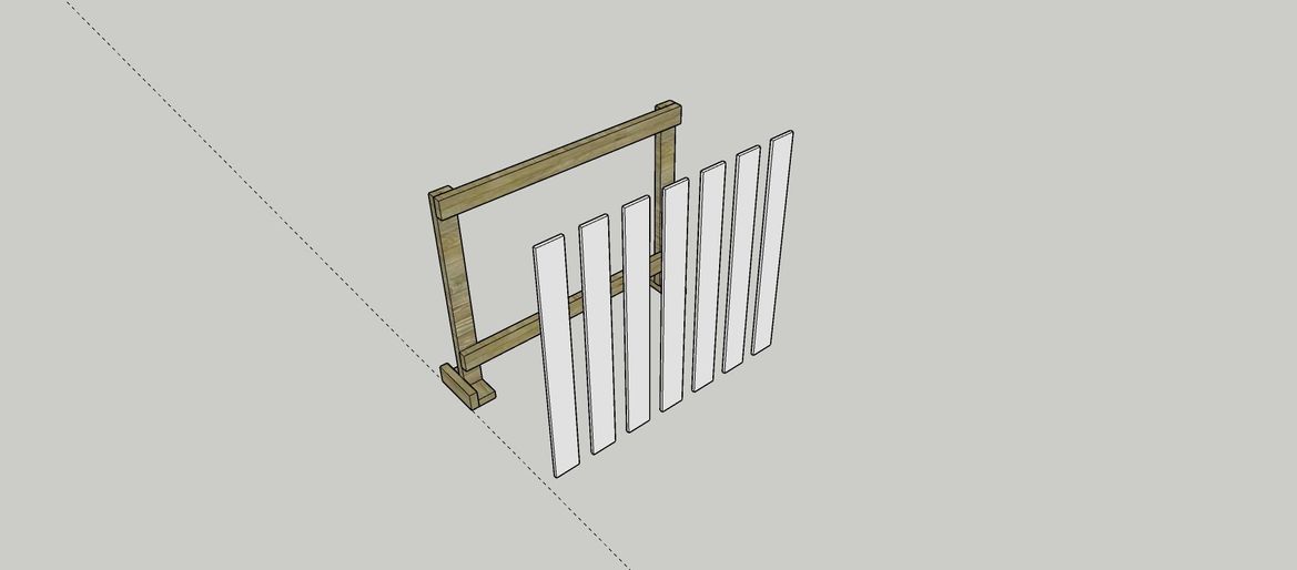

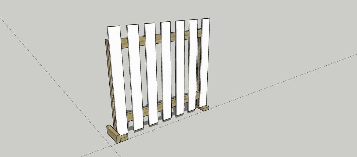

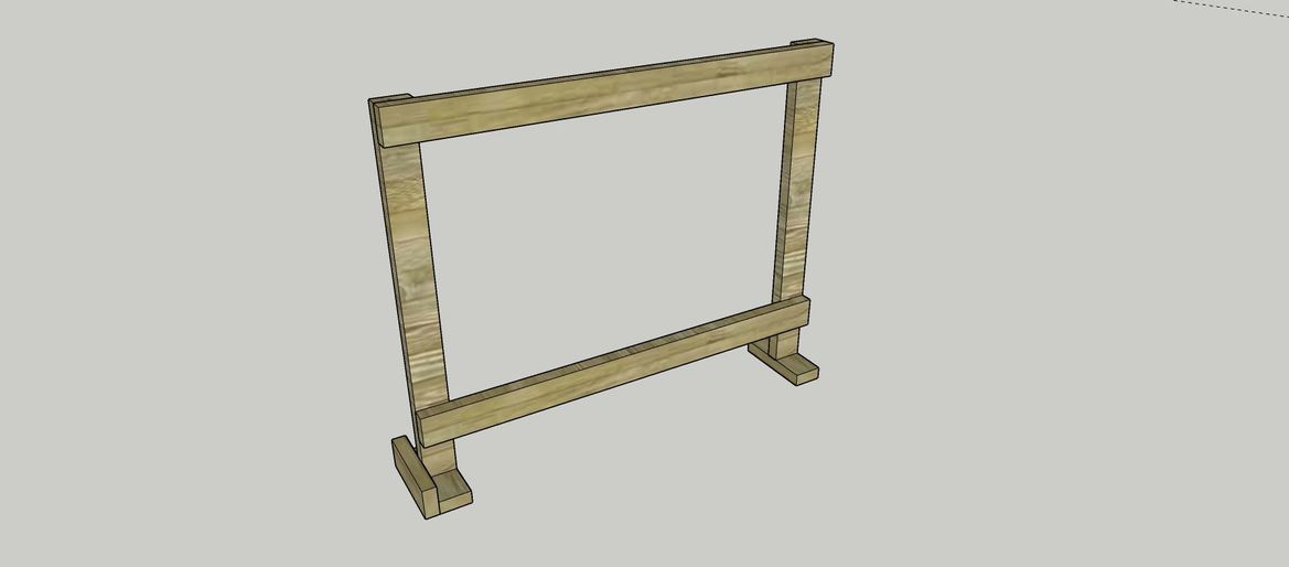

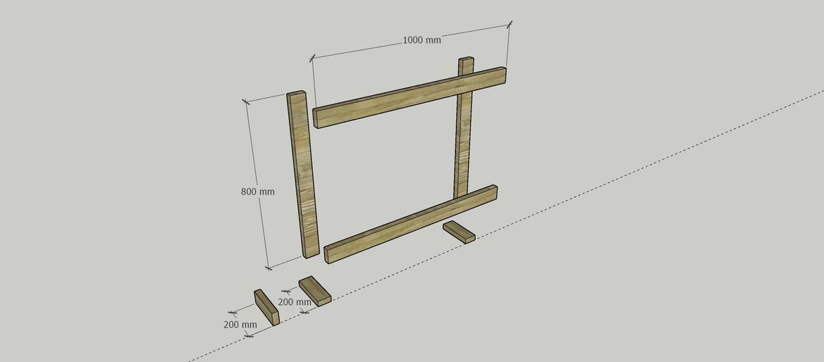

Thank you for your patience. I've placed the sample images below to give you an idea of how it's put together. In regards to the paint, I suggest using British Paints 1L White Semi Gloss Doors Windows And Trim Paint And Prime
Please note that the second fence does not need feet. This will prevent it from getting entangled with the first fence. The sequence will then go that the third fence will have feet, the fourth panel will not have feet, and the final part will have feet. Please note that the measurements are for reference, please adjust them to your needs.
