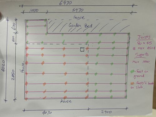

Hi I’m looking at starting a low level timber deck in a recently built house but just need some advice if I’m on the right track or someone to steer me in the right direction.

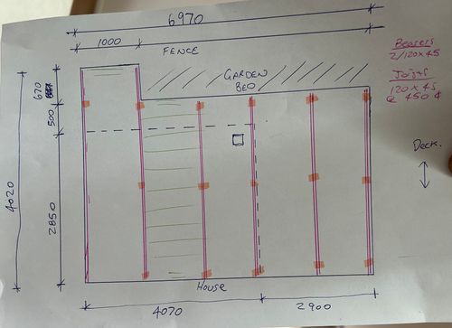

I’m thinking single height subfloor and will be built on existing slab and on ground. I have 160mm height to work with on the alfresco slab but can dig out some additional ground to get more clearance. Currently this is what I’m proposing.
- 120x45 wailer bolted into brick work
- 2/120x45 bearers (pink lines) supported by adjustable feet (on concrete) and posts in ground. I was going to span approximately 1600mm.
- 120x45 joists @ 450 centres in between bearers fixed with joist hangers. Max span 1500mm
- 140x19 spotted gum decking with 5mm spacing. Deck direction North/South looking at my sketch
- I will set deck out for a picture frame boarder
- On the natural ground laying approximately 50mm of stone to help with drainage.
Am I on the right track? Im not 100% sure on the spans and also the section of the deck on my sketch top left there will be a 600-700 cantilever I’m not sure will work.
I have also seen frames set up with just joists at 450 centres supported by feet and posts with noggins nailed in between.
