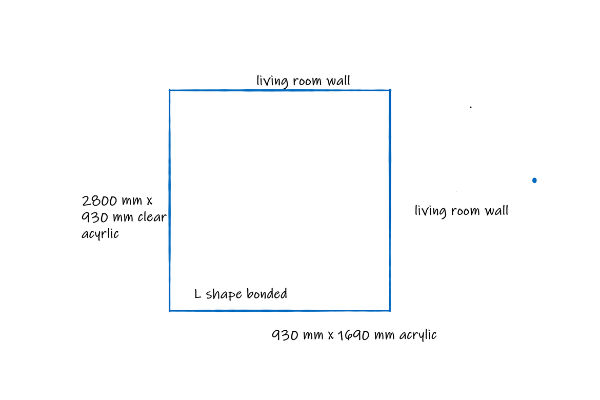

Thanks so much. The L shaped enclosure will start at floor level and extend up to approx waist height. The cages will not be on top of the structure they will be 'inside' the structure with the L shaped structure in effect acting like a boundary wall to keep seed and debris in. I have enclosed a very rough sketch of how I visualise the two pieces of the L will intersect to complete the rectangle with the other L in the rectangle being the two walls. I have enclosed rough measurements also of the two arms of the L based on their distance from the two walls of the living room. And I am envisaging having a 'door' cut into the acyrlic sheet to get in and out of the enclosure. Thank you so much Mitchell for your help with this. It is greatly appreciated.

Partha L Shape dimensions

I suspect you'll need to construct a solid timber frame that can be mounted to the wall on either side with angle brackets. The frame will not only hold the acrylic sheets but allow you to butt the smaller sheets together. I'd suggest placing your access door against one of the walls as you'll need a solid point to mount hinges.
Here are some images to get you started. They are drawn to scale using the 900 x 600mm acrylic sheets.
