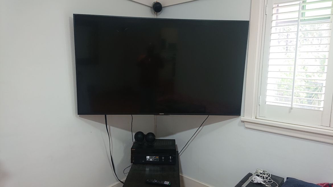

I need help on making a corner shelf which room in the back to run wires. I want to put a shelf which I place amplifier and sub woofer on the floor just beneath that.
Amplifier size in 45*30 cm , looking at the corner area it would have to be timber or board running diagonally and leaving room behind to run wires ( 100 *50 cm) . Currently this in on a TV trolley which is just waste of space. Shelf just below TV will look great and functionally better.

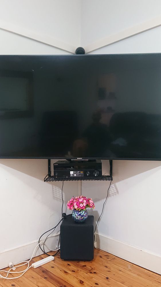

Hi @EricL
I finally finished this. Decided to use something different as we wanted to make as minimal as we could. Attached is the final product. Just waiting for electrician now.
Cheers
Hello @notshyofeffort
Thank you so much for the update. It's great to see that you've found a solution to your shelving. It looks very nice and compact.
