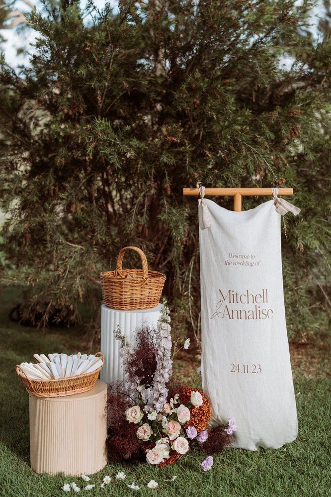

Hi I was wondering how I would go about building sign holder on the right to be able to hold a linen sign on/ have it stand still in the outdoors.
Also the type of tools needed for it. Thank you!
Hello @maddyb94
Welcome to the Bunnings Workshop community. It's sensational to have you join us, and thanks for sharing your question about building a wooden sign holder.
I propose using Porta 42 x 42mm 1.8m DAR Square and cutting a portion of it to form the top section. You can use your linen sign as a reference on how long it should be. To assemble the sign, I suggest using Zenith 38mm Zinc Plated Angle Brackets - 4 Pack on each side of the post to hold the top part in place. Once you have the post assembled simply place it into a bucket with medium sized stones or gravel to hold the post in place.
Please note that the sizes are for reference only, please adjust them to your needs.
I've placed a sample image below to give you an idea of how put it together.
