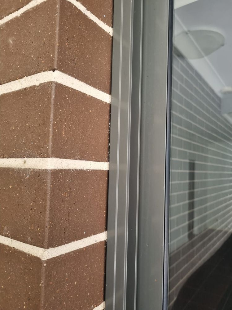

Can I have someone's expert advise on what color filler go with my window frame?
I don't even know the color :smile:

Hello @amirwayn
Thanks for sharing your question about what colour filler to use. If you were to use use a white sealant such as Selleys 600ml White Flexiseal Polyurethane Construction Sealant it would blend in with the white cement mortar which in essence is not bad. There is also the Selleys 600ml Grey Flexiseal FC Polyurethane Construction Sealant And Adhesive, the grey colour would blend in with the silver-grey finish of the aluminium sliding door. Both choices will work well, and the decision really comes down to the appearance you prefer at the point where the door meets the brick wall.
