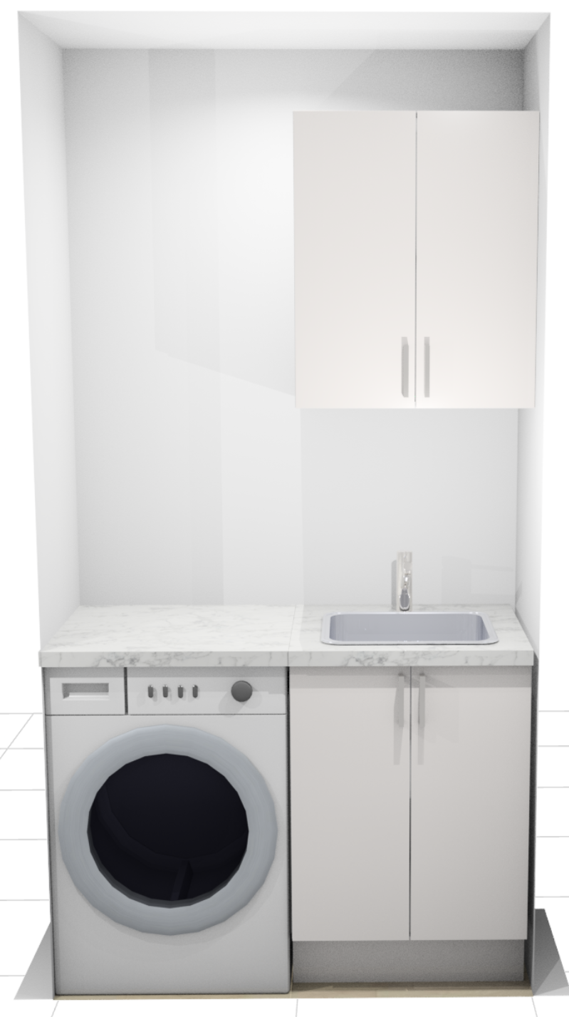

Hi @ELI5,
These days, most people replace older laundry tubs with a cabinet-style unit that has an inset tub on top. This setup looks more modern and also gives you the option to run a benchtop across the cabinet, washing machine, and even under a wall-mounted dryer for a sleek, built-in look. If you can share a few more details about the space, such as the dimensions, existing plumbing layout, and whether you would like extra storage, we can suggest some specific products and layout ideas to suit your laundry area.

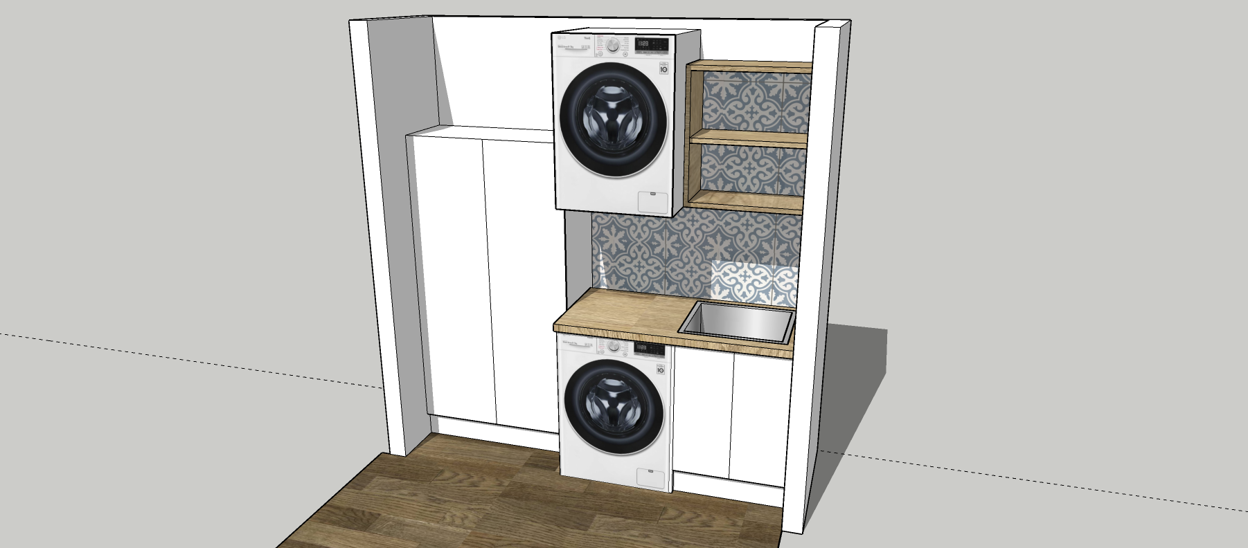

Here is the picture, the section is about 90cm, where I intend to place a  180 by 90cm cupboard in.
Re: How to change laundry tub
Hello @ELI5
I've drawn up a sample layout for your laundry. If you are going to use an 1800 tall pantry, I suggest looking at the Bedford Furniture 900mm White 2 Door Pantry. Please note that the Bedford pantry is not as deep as standard kitchen pantries which are 600mm deep.
