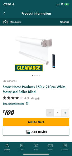

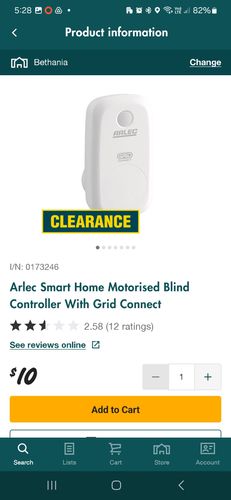

Hi the brand is smart home products motorised blind and a arlec smart home blind controller (sold in bunnings)

i presume you've setup and connected the Arlec blind controller in the mobile app? Is it appearing, and what roadblocks are you encountering?
Yes blind is set up and works with the remote
app is installed and has found the wifi bridge and the blind is on the app it’s just that no matter what I press there’s no interaction between app and blind ?
many thanks
@sheene7, If you have these 2 then all should be fine I would say the issue is going to be pairing EZ vs AP mode, EZ mode is the quick flashing mode and is less reliable to connect where AP is the slow blink or pulse and is more reliable.
To get into AP mode enter into EZ mode like normal by holding normal for 5 sec then let go it will flash fast, then hold down again for another 5 sec and it will begin flashing slow this is AP mode. Let go and start to pair, up the top right hand side you will see EZ click on that and change to AP and continue, it will go through the normal motion then it will ask you to connect to another network be at a ARC or SMART network connect to it and then it will probably say no internet access select this time only and then once back on the wifi list and connected to that smart device back out of the screen until you get back to the Grid Connect App.

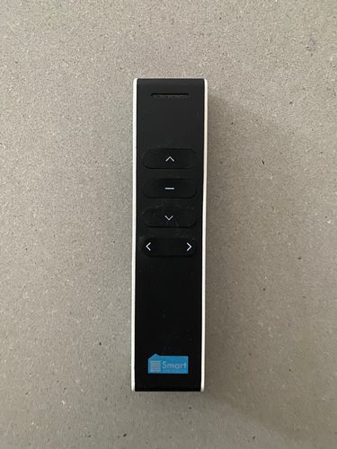

I found your post by luck. Do you happen to have the manual for the remote control? Or would you be so kind to share the instructions of how to pair the blind to the remote? I just got this place where it has the same system you’re talking about but my blinds don’t connect to the remote control.

Can you please let us know if your remote has a model number, I tried tracking it down but could not find it. Once you give us the model number we might be able to track down the manual for it.
Let me call on our experienced members @CSParnell and @GreenHouse for their recommendations.
Hello @gabofonseca
This link may help:
https://smarthp.co.nz/wp-content/uploads/2019/12/Motorised-Instruction-Print-v.3.pdf
Note:
It does not appear to be a 'Grid Connect' compatible remote.
I think it's just a proprietary dedicated wireless remote for controlling compatible blinds.
