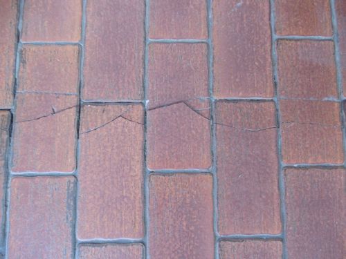

This slight crack has been there 20 yrs.   Following changing a beam underneath it has buckled.   The idea of pulling all the tiles up and laying lino doesn't excite me.    There are decking squares although may not sit up high enough, also expensive.    Any ideas?   The marine carpet idea doesn't excite me either.   Unless I have to pull up all the tiles and retile it.

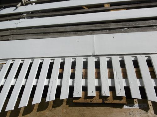

Been awhile since I could get there, chronic illness.   So there is now another crack in the tiles, from underneath a little bow - the pic doesn't really show it but it gives you an idea of how it was constructed, the cracks on top are either side of the bow.     I've taken a pic from the side but doesn't really show what the floor was made of.   The tenant - a chippie - is quite confident its not going to fall down but he doesn't think it has a concrete floor & has no idea why they put a tiled top on like they did.   As soon as the balcony moves a bit the tiles will crack.    The side shows a ply cover which doesn't really mean the balcony floor was made of ply.    Over 20 years it has had some heavy weight on it.   As I say he seems to be very confident its not falling down, just says they should have used something other than tiles on the top.   Hope the photos shed some light.
   The bits of timber under the balcony is the chippie's stuff.    He has loads of it everywhere!   The grey/green color is the underneath of the balcony.

Looks like someone wanted a tiled outdoor area and to stop water drifting through to below. The floor would have been flat or made flat with masonite or chipboard, waterproofed if you were lucky and tehn screw plus tiles. Thats why you have those cracks as things move. You could go down the track of removing the surface and tyhen you would have to put a new one down, tho as Eric has said it would be a lot lighter.

Thanks for posting those extra photos of your tiled floor. Since there has been another crack that's developed on the tile floor, odds are that whatever is underneath the tiles is shifting as well. If more shifting occurs more tiles will probably get damaged.
I propose speaking to a builder or a handy person and getting a quote for tile removal and resurfacing the top of your balcony with either timber or cement sheeting. In this manner you'll have an idea of what the job will cost.
