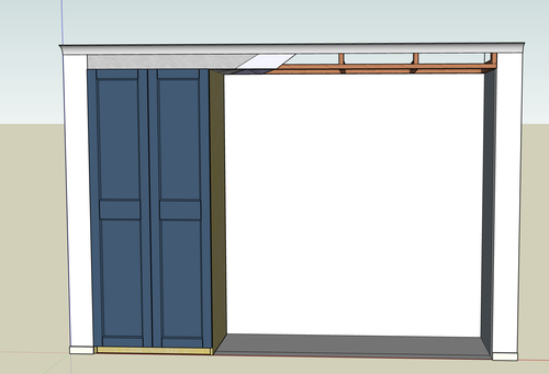

I've decided to replace them with Ikea Pax wardrobes however there will be a ~20cm gap to the ceiling which I'd like to fill in.

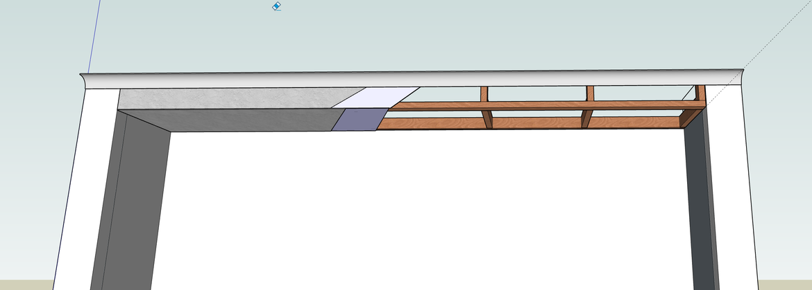

My preferred option would be to frame those 20cm , apply blueboard or FRC sheeting and then render over it so it transitions cleanly from the cement rendered brick wall.
I found there are a few acrylic multipurpose renders (e.g. Davco PM Render) which will adhere to brick/cement and blueboard and was hoping to use that to make a seamless transition
-White walls on the side are brick with cement render
- top section would be framed (potentially just the front leaving a gap at the back to save on cost)
-grey/blue is the blueboard with the applied render over the top
My main issues are that I don't know how the transtion between the brick to blueboard is going to hold up or if that will just crack. I haven't found anything online about anyone making such a transition which makes me wonder if that's just not achievable the way I am envisioning it
