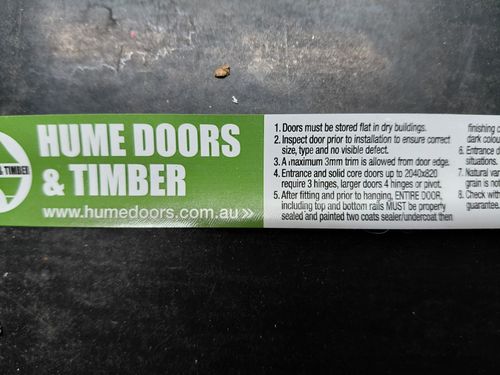

Hi @JohnsonZ there should be a sticker on the side of the door noting how much can be trimmed off, the below was on an internal door I recently fitted but I think all Hume doors state the same - maximum 3mm off each side. Any more than that could void any warranty and/or affect its structure.
