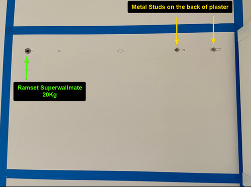

Referencing to this discussion, to fix a wall mounted cabinet to plaster ( within the area of blue coloured painters tape as shown in below image), screwed 'Ramset Superwall mate' to one extrement end of the fixture that holds the cabinet.
Unfortunately drilling hole ( at the location available in the fixture ) on the other end of the fixture ended up in front of metal studs. Tried another location and found the metal stud again, as informed in below image. The weight of the cabinet is around 12Kg.
What is the type of screw, I need to buy from Bunnings that pierces through the metal stud and holds the fixture in place for mounting the wall cabinet to the plaster.
Regards
M.Muthu
For the steel frame behind the plaster, I understood from the builder that the steel frame thickness is 0.7mm and the cross section is unknown.

I often over-engineer my fixings, I suggest using the Ramset Super Wallmate Toggle Anchors 3 more times on the plasterboard side of the wall. One below the one you've already installed and two more for the centre of the cabinet. I then suggest using Zenith 12G x 65mm Galvanised Hex Head Metal Screws on the right-hand side where the steel studs are. I recommend a minimum of three screws one for the top, middle and bottom of the cabinet.

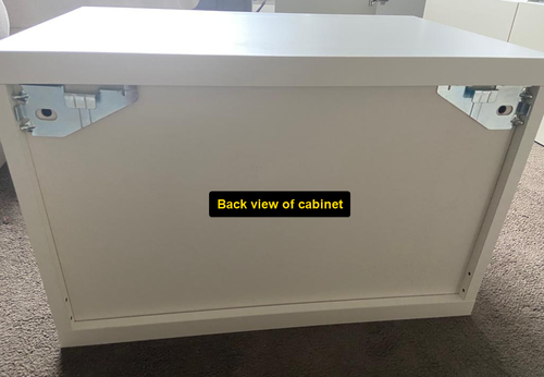

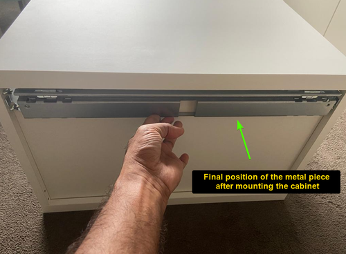

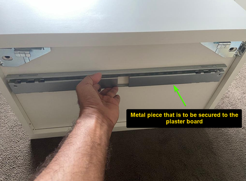

Sharing the view of the cabinet and wondering that on fixing the fastners at other recommended positions. Will Zenith Metal screw 12G bear the load of 20Kg?
