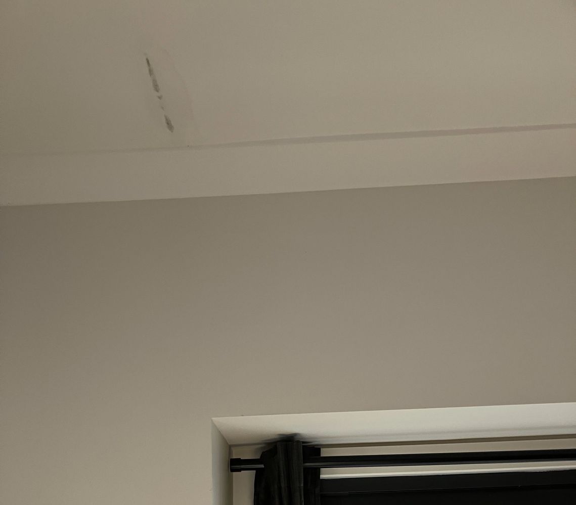

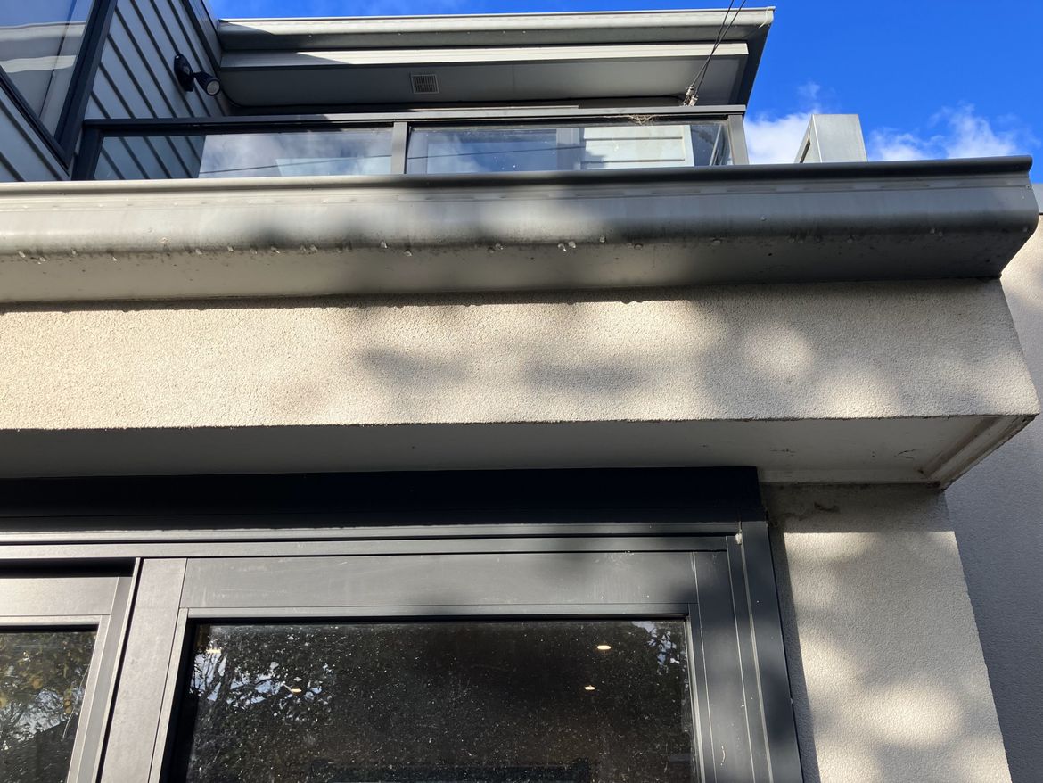

Hi all, my sister reports some water damage in the ceiling of the lounge room in her townhouse. I've included some photos that I hope will narrow down the problem. What you think, blocked gutters (although there aren't many trees around), or other trouble spots.

Thanks Eric, been a fair bit of rain in the last 24 hours, the ceiling is no worse, I'm still not sure that I've found the issue, although silicon is a marvellous invention.

I suggest going with @Nailbag's suggestion and getting a leak detection service to come and scan your area. You'll definitely see where the water is passing through as they have various tools to see and detect water ingress.
