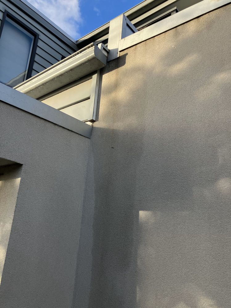

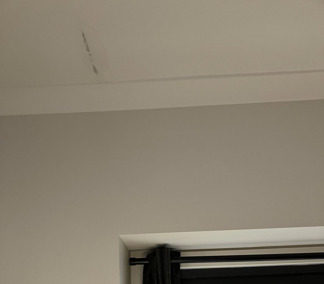

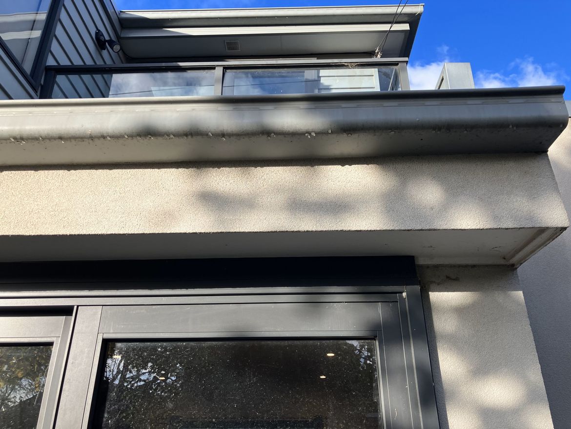

Hi all, my sister reports some water damage in the ceiling of the lounge room in her townhouse. I've included some photos that I hope will narrow down the problem. What you think, blocked gutters (although there aren't many trees around), or other trouble spots.

Yes, that would be the first area I would suggest investigating. Cleanout the gutters and make sure that there are no blockages along the gutter. I also suggest investigating the flashing on the nib wall to make sure that the there are no cracks and splits along the length of the flashing. One other way to determine the source of the leak is to spray the area with your garden hose and observe where the water flows and why it is leaking towards the wall.

It looks like there is the potential for significant damage so I would be strongly considering engaging a roof plumber.

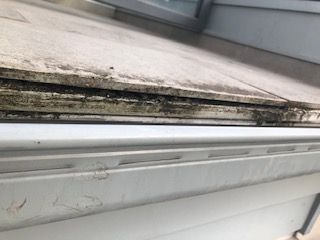

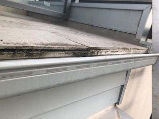

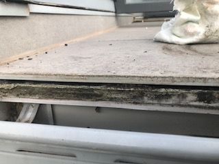

I repair a lot of internal damaged caused by water ingress from issue with guttering. Quite often the gutters are full of debris turned to mud, because owners believe gutter guard is protecting them or there are no trees around for leaves to cause issue. But neither stop dirt building up over time. The other surprising common issue is that the gutters are falling the wrong way and holding water (see pics). So when it rains they easily overflow. The drip line under the edge of your gutters indicate they are overflowing due to these reasons our a down-pipe issue as there are no drips at the edge of the eve underneath.

Update: Had the chance to get up and have a closer look, gutters were fine, there was a little bit of decomposed soil but not enough to cause any issues. Downpipes were clear. My sister told me that the builder did have to come back 2 years after the place was built because the tiled balcony had moved a little and that created a similar leak to the one we see now. I have siliconed where I could between the edge of the tiles and below as there was a slight gap in places but directly over the ceiling leak all I could see was a very slight crack in the grout in between the tiles, I put some silicon in there to seal it off. The photos also show some efflorescence and a slight crack in the Hardyplank but this is a metre at least away from the leak. The silicon is just a stopgap so need a longIMG_1454.jpgIMG_1455.jpgIMG_1456.jpgIMG_1457.jpger term solution.
