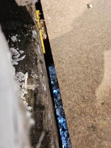

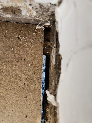

I have just had to restump my 1930s house, and the old T&G has been replaced with yellowtongue. Due to the "cut-in-floor" construction method, the floor boards but up against the bottom plates of the perimeter wall, but as-per requiremetns leave a 10mm expansion gap. Through that gap ic an see straight down to the subfloor area and soil. Once i put skirting back up, that will be the only thing between the outside air and the inside of my house.
What is the best product / technique to use to seal this space?

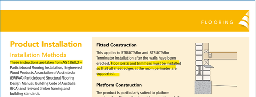

EDIT: after looking at the installation manual for the product, it reccommends installing timber trimmers in between joists to carry the edge of the floorboards (which would also help stop draughts) is this recommendation backed up by a reconginsed standard, or is this just a manufacturer recommendation?
