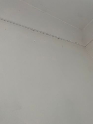

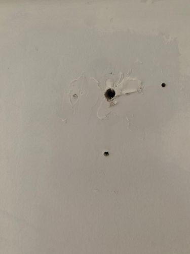

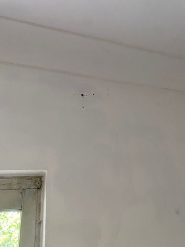

Hi! I’m new to home improvement and have tried to install some curtains in my unit! I have successfully drilled into the concrete wall on one side using a RYOBI hammer drill, but on the other side, I meet resistance after about 10mm. I persisted for hours (drilling pilot holes, enlargening and allowing the drill bits to cool down in between), and still can only get about 25mm deep. In a moment of defeat, I installed the anchor and curtains in the too-shallow hole and tried to secure them with spakfilla, only for the curtains to fall down (unsurprisingly) The masonry anchors I am using require 40mm deep holes.
I have drilled so many holes in this area at this point (and learned how to fill them), but meet resistance and very time!
I am using RYOBI masonry hammer drill bits, but have reached the limit of my knowledge.
Should I buy an expensive stud finder that works on concrete walls? Should I just use masonry wall anchors that only go 25mm deep, and will that be enough? It has to hold two layers of curtains, one sheer and one black out so a few kg.
