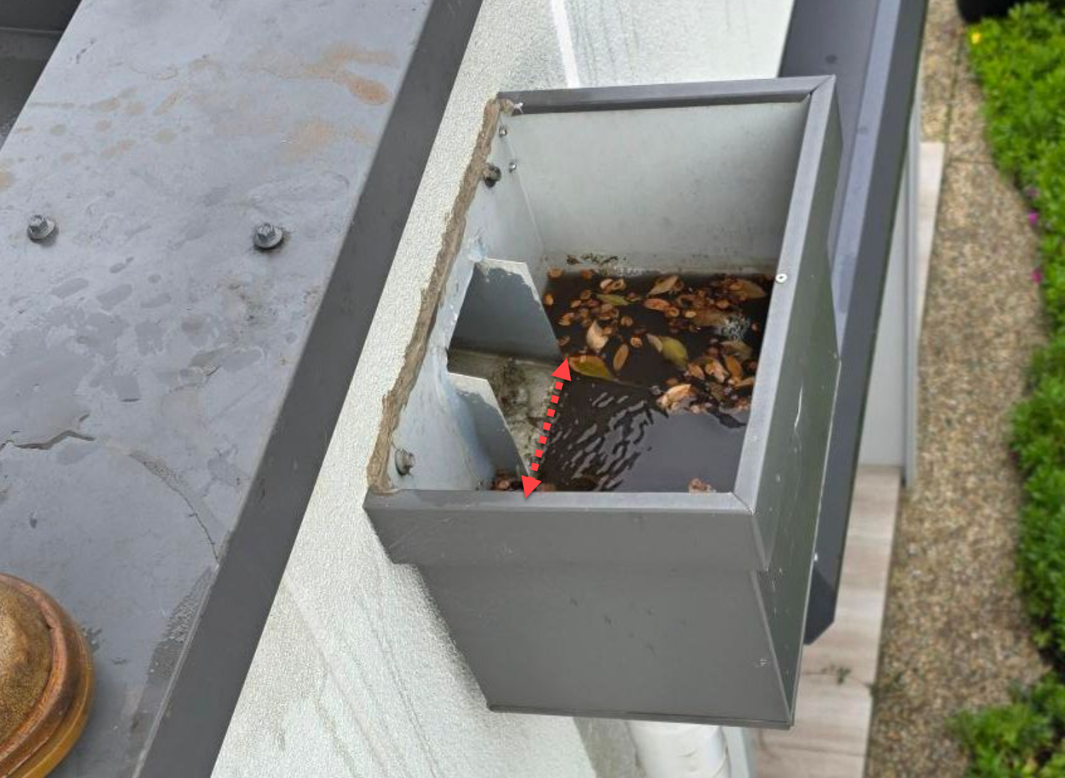

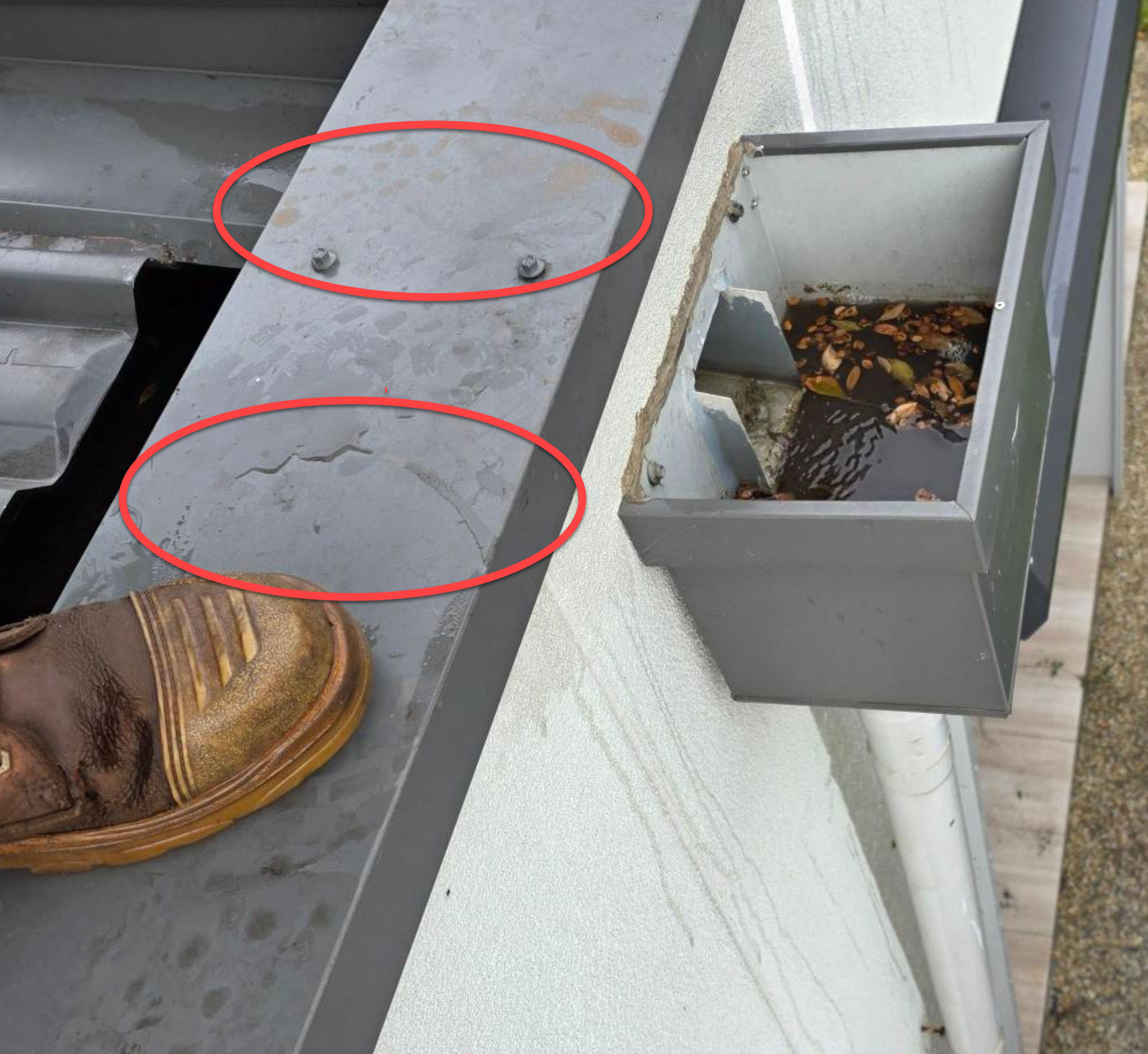

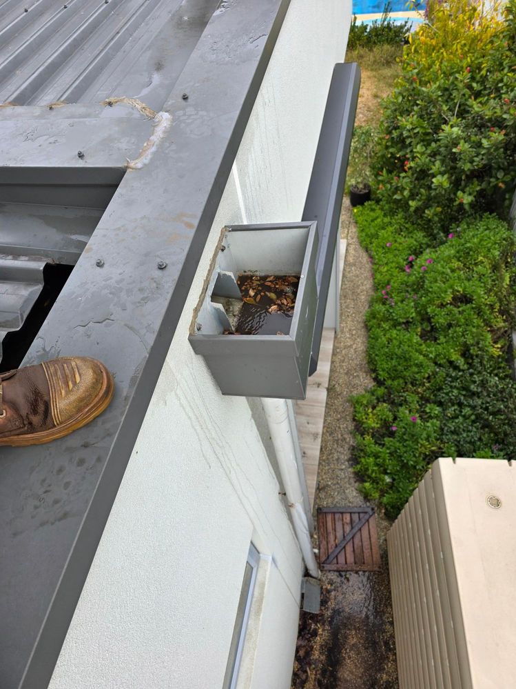

We have had issues with the backup of water due to the downpipe from our box gutter getting clogged and also with the box gutter not emptying properly into the header box for the downpipe , even if the downpipe isn't blocked. For either or both of these reasons, the water can sometimes start ponding in the box gutter itself during heavy rain. The gap between the box gutter, the wall and the colourbond roof was never filled by the builder, so if the water builds up in the box gutter and reaches the level of the gap, the water leaks into the wall (and from there into the interior of the house e.g. around the window frames on either side of the downpipe).
We have cut a hole in the base of the downpipe to prevent the water from backing up but there is still a potential problem with flooding due to the box gutter not draining easily into the header box for the downpipe. As you can imagine, access under the toe of the colourbond roofing sheet from the inside the box gutter is difficult (see photo, just to the right of the boot that you can see), so normal silicone caulking using a caulking gun would be difficult or impossible. I am thinking the easiest solution is to spray expanding foam into the junction between the colourbond roof and the top of the wall / interior side of the box gutter, using an applicator nozzle. Even if the foam is supposed to be waterproof, I'd probably then spray the foam with Selleys Roof and Gutter Spray Seal or similar. However, I can't find an expanding foam that specifically says it's waterproof (maybe they all are so they don't bother saying?), and the Selleys spray says it may be incompatible with some plastics eg. polystyrene, so I'm worried it will damage the expanding foam rather than seal it

Is the issue that the water is backing up in the header box, then when it backs up above the level here -
 - it is backflowing into the box gutter that runs through the wall, where it spills down into the wall?
If that is the case, I would think the best way to address the problem is to prevent the header box from backing up to the point of overflowing.

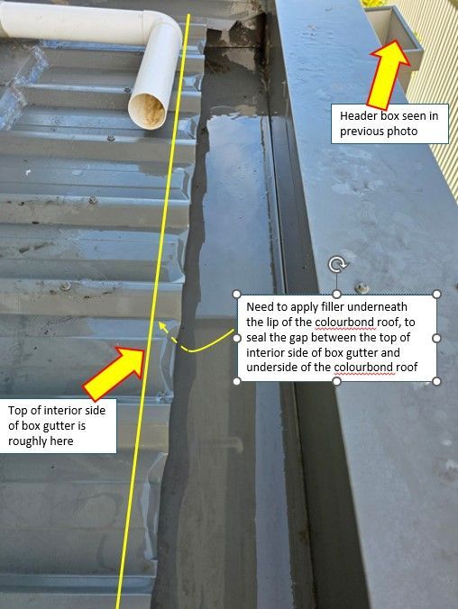

You're correct that the header box doesn't seem to be draining very well, but there is also a problem with the box gutter not draining very well into the header box, even if the header box itself is not full of water.
Hopefully the photo below gives a better idea of where the gap is that needs sealing. Dave-1 has separately suggested getting the header box and downpipe sorted out professionally, which is a valid comment. I'd probably still like to seal the gap too, so I've covered both issues that are feeding into the overall problem!

when it comes to any internal water ingress issues, especially from a 2nd story roof, then "bodge jobs' in my opinion are definitely not the way to go. The potential to slow or simply redirect the water internally without any obvious immediate issues is highly likely to raise its ugly head downtick at major expense and heartache. When you apply foam into an internal space you can't see the final result from is to hit and miss. Plus expanding foam is not a waterproofing solution.
I'm inline with @JacobZ recommendation to get a plumber who specialises in roofing to fix the issue or I would probably start with a leak detection service. This is the type of issue they can find the source/s of using infrared scanning cameras. Their report will then enable you to either fix the issue yourself or get a plumber in.
