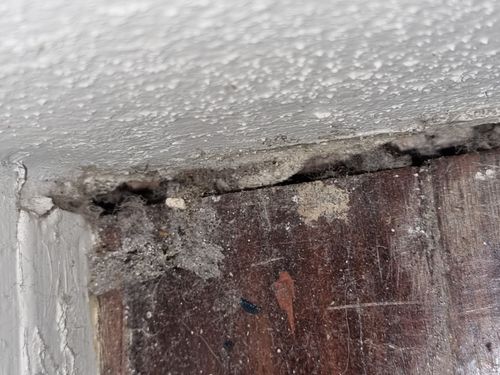

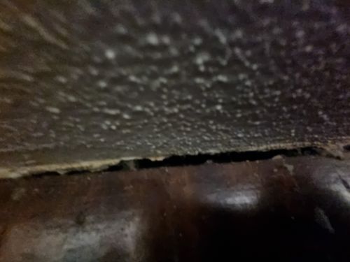

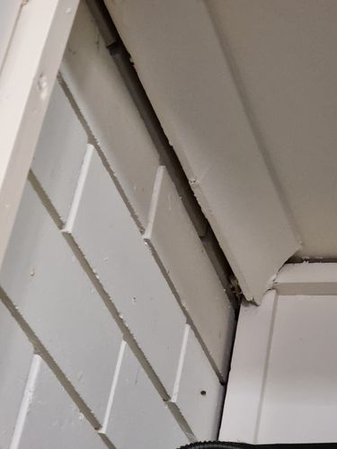

We have some areas in our house were the flooring and foundation have pulled away from the wall. How do we fill these in? Thank you

Could you please tell us what kind of floors you have? It's a little hard to see from the photos. And what are the walls? Perhaps just some wider photos might help members to see what you are working with if you are unsure.

My apologies for the late reply. I totally agree with your observation that there seem to be quite a number of gaps. I suggest fixing them in sections. I recommend using Sika 310ml White SikaSeal Acrylic 100 Gap Filler for the gaps on your floor. If you have old silicone attached to the wall I suggest removing them with a 100mm Sharp Edge Paint Scraper making sure not to damage the wall while removing the old silicone.
I suggest covering the gap on the ceiling with a Porta 30 x 18mm 2.7m Primed Finger Jointed Pine DAR. Measure the size of the gap and cut a piece of the timber and use Selleys 420g Liquid Nails Fast Grab Strong Adhesive to glue it on the inside gap of the crown moulding. It may be worth engaging the services of a structural engineer to find out if the movement of the foundations is severe enough to warrant a repair.
Here is a handy step-by-step guide: How to silicone a gap
