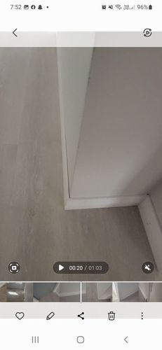

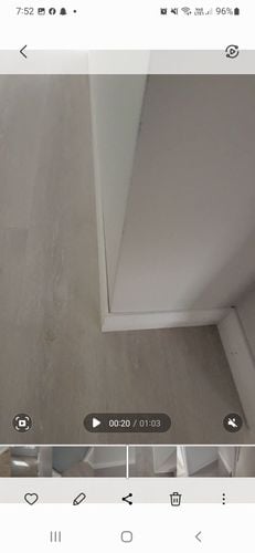

Had some skirting installed yesterday, don't think it was the best job but anyways, have some small gaps between skirting and wall in some areas not all, please see attached pics.
What do I use to fill these gaps

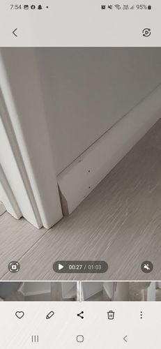

Also have some areas wherewhere the skirting is pretuding looks awful ideas to fix
Welcome to the Bunnings Workshop community @xircomnz. It's wonderful to have you join us, and many thanks for your question about filling gaps in skirting boards.
When installing skirting boards, a certain amount of filling gaps will be needed. Although the walls appear flat with perfect right angles, in fact, they are anything but due to the plaster filler mounded up over the external plaster corners. I suggest using Selleys 475g No More Gaps Interior Multipurpose Gap Filler and taping off the wall and skirting next to the gap with painter's tape. You can then fill the gap and smooth the filler off with your finger, which you've dipped in soapy water. You can then remove the tape to reveal a perfectly filled area.
It's a bit difficult, with the thicker skirting meeting the thinner door trim. You could potentially do a tapered cut to minimise the harsh step or add a small section of quad beading that's been cut to the same profile as the skirting.
