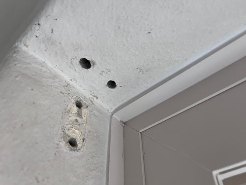

I'm replacing my kitchen roller blind and didn't realise until I took the old one down how dodgy previous installs were. I've removed all the wall plugs and painted over brackets but now there's quite a few sizeable holes in the top (ceiling) and sides of the window recess, which is concrete.
I've got some Concremate to fill the holes, and my first question is:
1. Is there a trick to getting the Concremate far enough into the holes and making sure gravity doesn't thwart the mission?

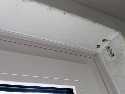

In addition to that question, I know it's usually advisable to make the new holes at least 10mm from the old ones but I'm not sure I can get them all quite that far away. I plan to bring the blind further away from the window and set it slightly to one side, which I think is as much distance as I'm likely to get. But the new screws will then be sort of offset between the existing holes and may be within the 10mm; I don't think there's any way to avoid that, which leads me to my other questions:
2. Will I still be able to drill (with a hammer drill and masonry bit) into the Concremate-filled sections, or is it likely to cause me problems?
3. And is there a particular point in the Concremate setting process, given that it strengthens over time, that's ideal for drilling the new holes?

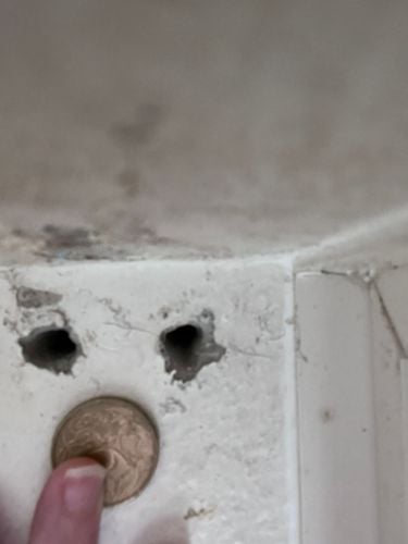

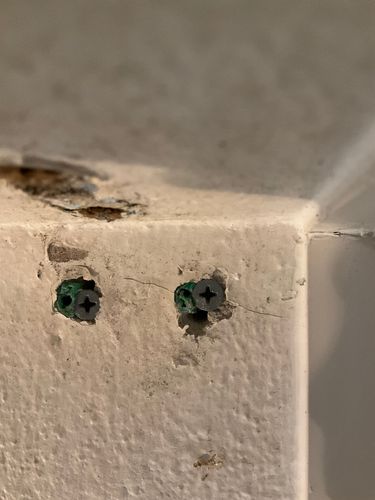

Just a note: some of the holes are deeper or wider than one would expect; a couple of them inexplicably had plastic plugs with a screw drilled beside them. $1 coin pictured for scale.
