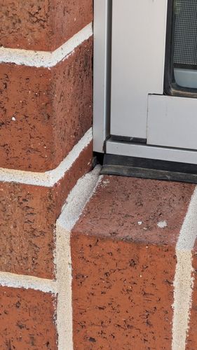

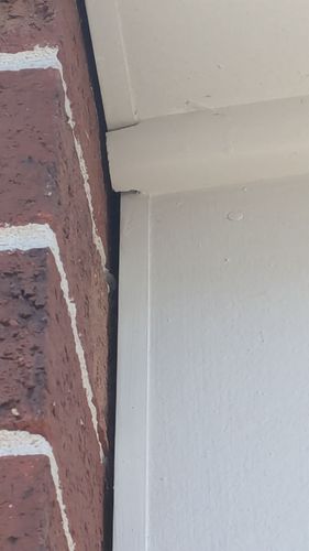

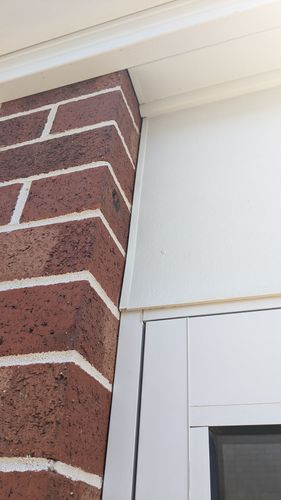

I have so no gaps ready to go but Ive notice some gaps are quite large. What would I use to fill and do I still use no gaps after?
To prevent excessive wastage, you might like to push some filler rod into the gaps before applying the No More Gaps, @amichaelmedia. Once you've filled the gaps with filler rod, you'll be able to use the No More Gaps over the top.
