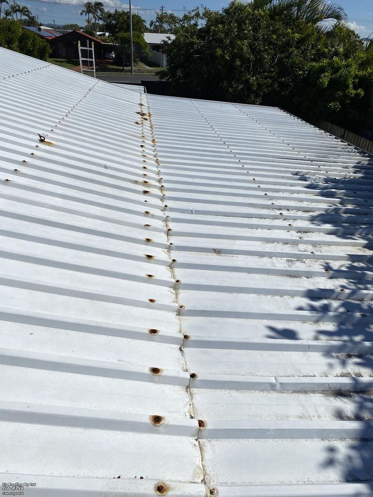

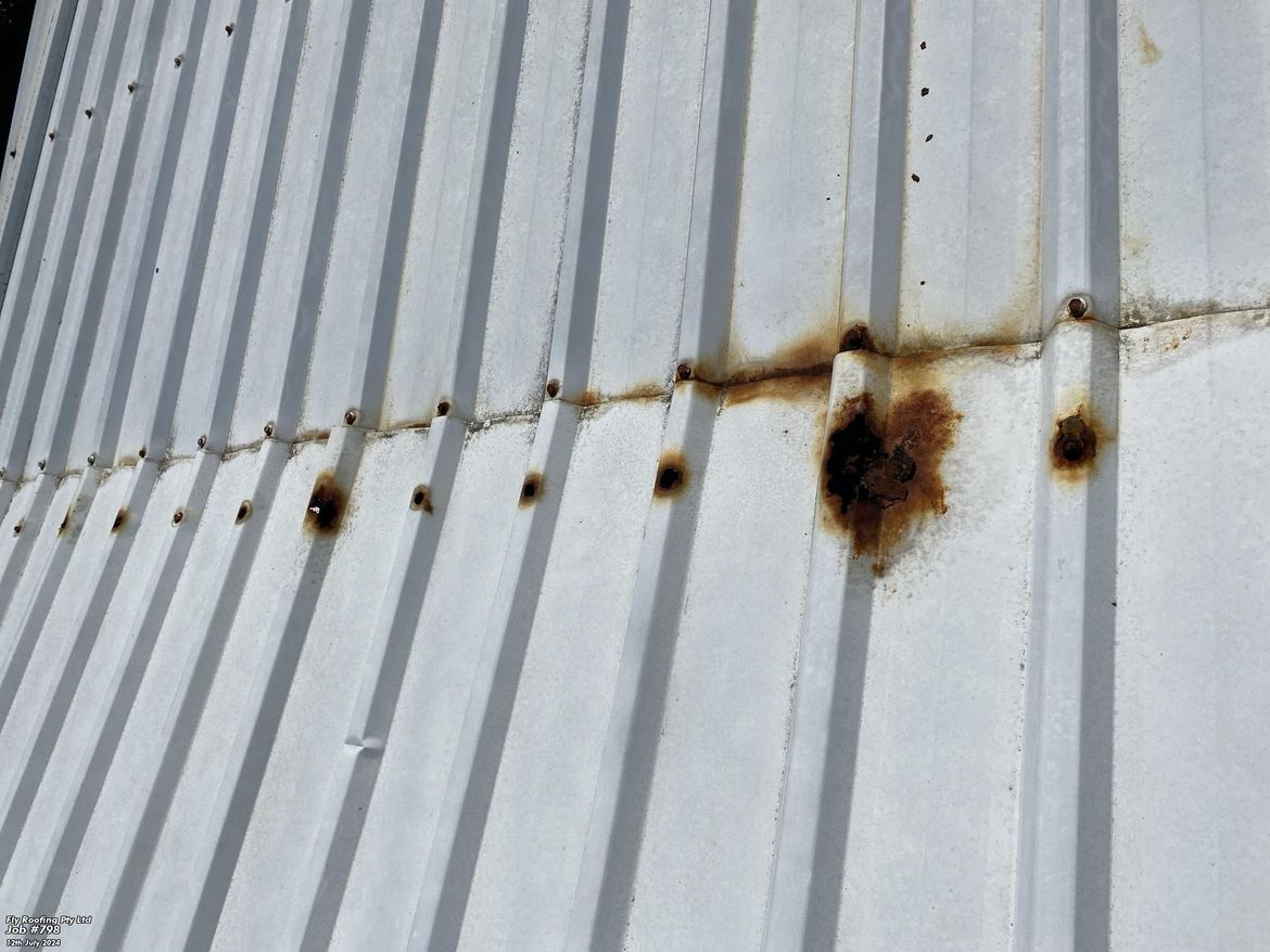

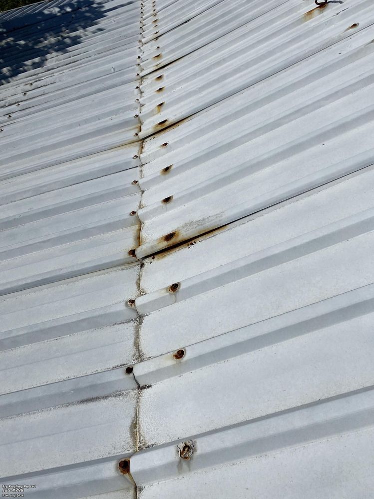

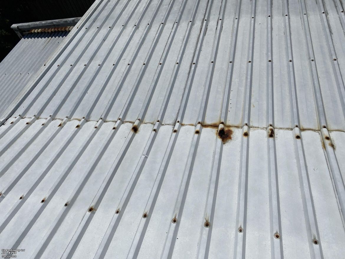

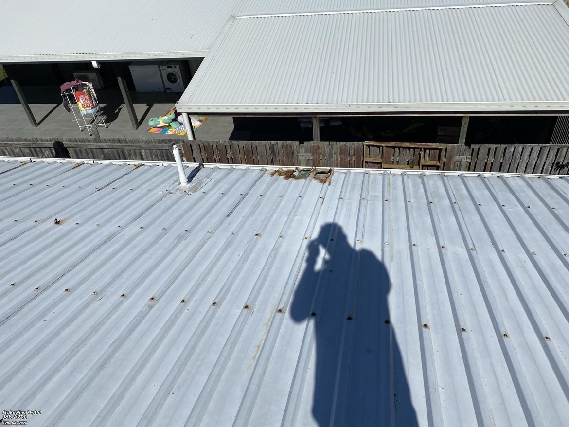

Hi everyone,
I recently purchased a house and was planning to install solar panels. However, upon closer inspection, I realized my Colorbond roof needs some repairs. There are a few holes, some rust on the bolts, and a larger patched hole that seems like a previous repair attempt.
I've attached some photos of the roof for your reference.
Since I'm unfamiliar with roof repair, I'd appreciate your expertise on the following:
  • Overall condition of the roof: Although I haven't experienced any leaks inside the house, I'd like to know the overall state of the roof.
  • Remaining lifespan: Considering the current condition, how much longer can I expect the roof to last?
  • Repair options: Do I need a complete roof replacement, or could I potentially address the issues with repairs?
  • Screw replacement: Would replacing all the screws with a rust converter or sealant be a viable solution?
  • Patching large holes: What's the best approach to patching the larger rusted holes?
  • Patch durability: How long can I expect a patched repair to last (ideally at least 2-3 years)?
  • DIY feasibility: I'm considering tackling the repairs myself. Is this a very challenging task, or can it be done with the right tools?
  • Required tools: If DIY is possible, what tools would I need for this project (re-screwing, patching, painting, and applying sealant)?
This is my first time on this forum, and I would truly value your expert opinions on my roof situation.
Thank you for your time and assistance!
Sincerely,
Tariq

It appears that the overall condition of the roof panels are still ok except for the drill points which gave deteriorated badly. Unfortunately, it is difficult to predict how long a patch job would last. Please note that parts of your roof sheet will still be functional and provide coverage, but there is no stopping the advance of the rusted areas. Sanding, cutting and repainting will delay the rust, but it will not stop its advance.
From a repair point of view, I recommend doing a full replacement of the severely damaged panels. This ensures that you won't have to revisit this section of the roofing when the solar panels are attached. You can imagine having to remove the solar panels if the roofing sheets spring a leak.

I am wondering how large the rust areas are or if the rust stains make it look like the holes are larger?
The large areas of roofing definently I would replace part of the sheet (the last photo)
The screws that are rusted I would replace but the issue then becomes you are putting screws back into the same hole (needs a slightly larger screw) or a new hole and the old hole rust removed then rust protection and sealed. (make sure they are roofing screws with a rubber backed gromet).
Id actually go for larger screws, once removed the old ones, clean and rust proof the existing hole. Once dry then the larger screws into the panels. For the chunks of clearly rusted sheeting I would be cutting out the rust and slipping a new piece underneath to provide continuation of the roofiing. Make sure you rust proof the edge of the sheets you cut.
This should extend the life of the roof. Tho not sure how long. metals roof do rust with time and then its just a maintenance issue.

Hi @Tariq both @EricL & @Dave-1 have provided excellent advice. However before going down the path of repair, and for total peace of mind, I would get your quotes on the solar panel system. These guys have the knowledge and work with roofing plumbers to ensure the structural integrity before installations.
Your roof sheets appear to be Zincalume Klip-Lok, which is a cheaper steel product over Colorbond and is typically only clipped down not screwed as well. As @EricL  highlighted, once the system installed the cost to remove and refit the system should any of the sheets continue to rust will extend the period considerably the saving of having solar energy. I have a friend that spend $20K on a system fitted to a roof looking in similar condition. A little over a year later he started to get leaks in a couple of areas and it was recommended that the entire section of roof under his panels and then some be replaced. Other than the cabling the entire system was removed and refitted.
Personally I wouldn't be repairing any of the badly damaged sheets if I was intending to cover them with very expensive solar panels. A potentially small investment to replace a few bad sheets is also something you can do yourself.
Regarding replacing screws with larger ones, they only come in longer lengths not by diameter. You would need longer ones where the current length ones are not pulling in tight. And obviously rubber sealed ones.
