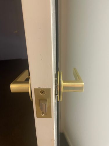

Hi there so I’ve tried that I’ve cut better space for the striker plate and the latch still doesn’t seem to fit. It will if you slam it but the privacy pin still won’t engage.
I have another issue now in that some of the handles I have bought have a different pin that goes through the lock and it looks like it’s too long and won’t allow the handle to be flush with the door.
tearing my hair out.
Re: San Fran privacy handle - Not locking when door closed
Is the latch perfectly in line with the striker plate @Jersey1975? Could you show us the sticker plate including the location where the latch enters it?
For the handle in your picture, if the bolts are not lining up then I presume the cutout in the door is not adequate. Did you check the instruction to ensure the cutout in the door was the correct size for the new handles? They might not necessarily fit the previous holes.
