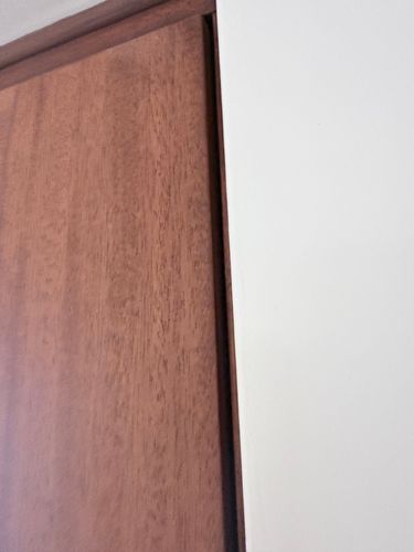

Welcome to the Bunnings Workshop community @Radha001. It's brilliant to have you join us, and many thanks for your question about fixing a door.When a door won’t close far enough to latch, the first step is to figure out why it isn’t fully seating in the frame. From your photo, it looks like the latch is in the correct position, but the door simply can’t reach it, which usually means there’s some obstruction or misalignment.
Start by closing the door as far as it will go and carefully check all around the frame. Look for any points where the door is rubbing against the jamb, which can happen if the door has swollen from moisture, warped, or if the frame itself has shifted. If the door is touching the frame anywhere before it reaches the latch, that will prevent it from fully closing. Warping can sometimes be spotted if the top and bottom of the door behave differently. For example, if the top won’t close but the bottom does.
Once you identify where it’s binding, you can decide on the right fix. Minor rubbing spots can sometimes be eased by planing the door or sanding down the high areas, and in some cases, the frame can be adjusted. Adjusting the striker plate is only a temporary or last-resort solution; if the door still doesn’t sit flush in the frame, moving the striker won’t fix the underlying problem. The key is to get the door to fully close into the jamb first, and then the latch should work as intended.

Another issue that can cause this is issues on the hinge side of the door. Some pictures of the outide of the door could help including pictures of the hinge side of the door and jamb both open and closed.
When did this start happening? have you had door seals fitted on the outside? Can you link the start of this to an event or weather conditions?
